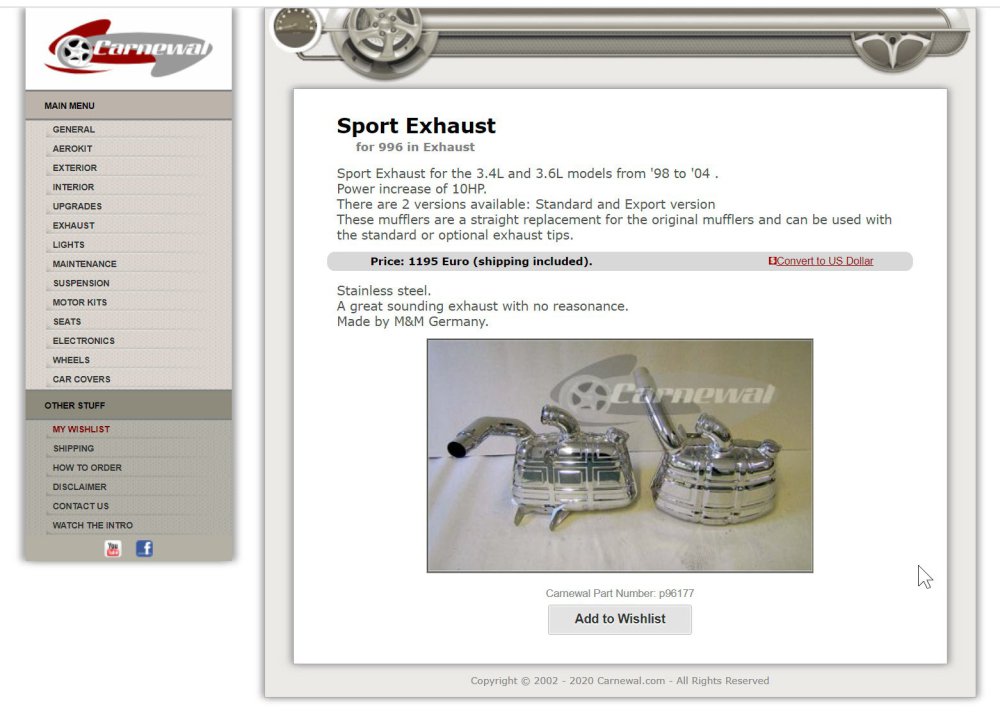

The exhausts are numbered 996.111.984/985.01, but I see the latest model ends .03. They look like the 03 model (per the pics on Carnewal) so looks like the right one for a 3.6 l car, but is there any difference between the models?

As long as thay are the "big tube" design they will work on any 996 (as shown on Carnewal.com).
It is the "small tube" version that Porsche says to use only on 3.4 liter cars.

What Carnewal sells is OEM Porsche parts.
I doubt there are any small tube exhausts left that are new. If order from a Porsche dealers their parts list will always show the latest updated part number and I think the big tube exhaust has been around since 2002.
