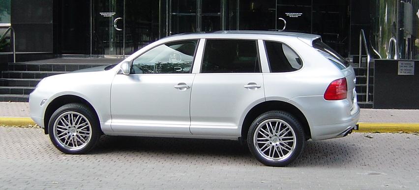

Here's a pic of my '05 CS with Victor LeMans wheels.

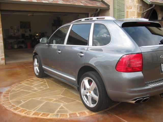

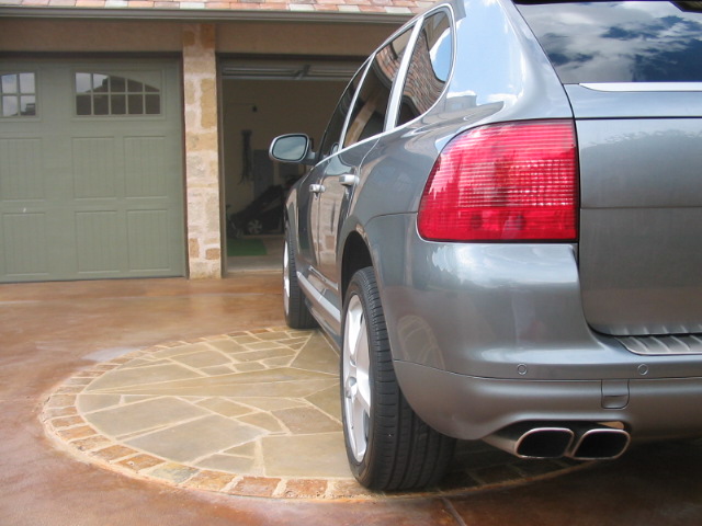

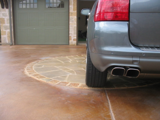

Here are the pics of my 05 TT with the 17mm spacers.

Thanks! Not sure on the offset but I believe they are 20x9 all around. I was originally unhappy with the look of the stock sport technos but spacers help give it more of an aggressive look. Would have liked to have gone with 22" in either Champion or Techart but this will do for now. Other mods were tubi exhaust, rocker panels, roof rails, and V1 hardwire.

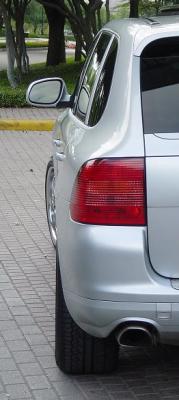

Here's a profile pics of my ride:
Looks great. I have to admit I don't see much of a difference in the offset but wow, I sure wish I had the wider 10s. Oh well, some day I will change to 22X10s but I think I'm about done with the upgrades for now.
