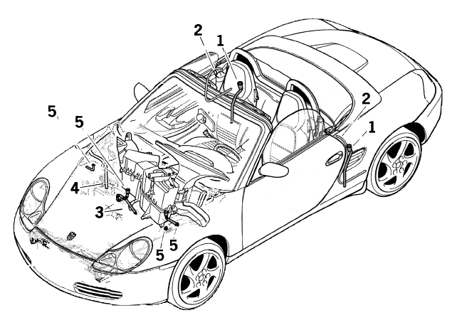

Am pretty sure this leak is coming from the airconditioning, its been not been raining and have had the aircon on and can still feel carpet is wet.
Can anyone advise where the aircon system runs, is there a filter tray or something underneath the seat or is it blocked somewhere?

Boxster Water Drainage
1 - Water drainage: water collection tray
2 - Water drainage: sealing channel on rear side section
3 - Water drainage: tank tray
4 - Water drainage: evaporator of heating and air-conditioning system
5 - Water drainage: radiator tank

Thanks loren, according to the diagram it looks like its the water collection tray or sealing channel on rear side collection thats blocked or causing the leak!
Loren, can u advise on how to access the water collection tray?
The drains were working properly when I flushed them out.
