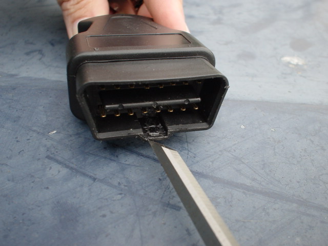

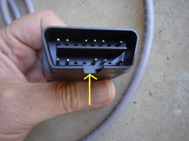

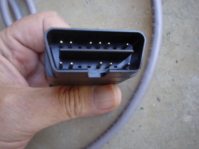

Can't tell if your plug has the same problem mine did. I do not have your tester. On mine there was a plastic tab which prevented the plug from seating. I carved away the plastic nub from inside the tab with a chisel, as in the second pic. That nub would prevent my plug from seating until I removed it.

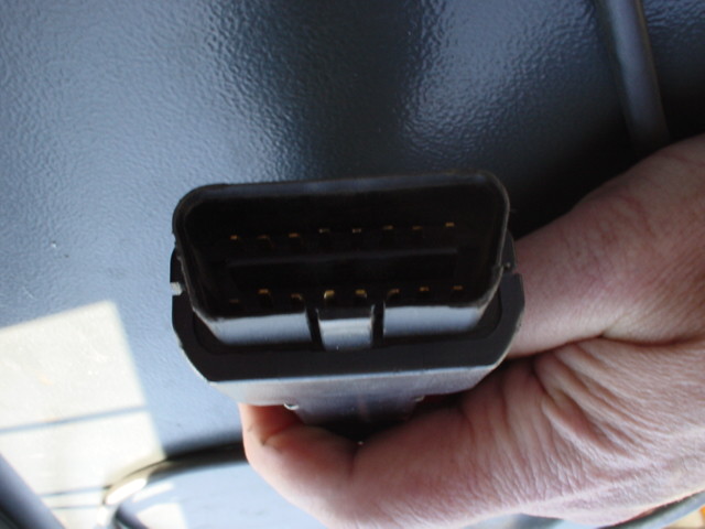

The first pic is Loren's plug. You can see that the entire tab has been removed so that the plug would seat.
That is EXACTLY it!!! Thanks Toolpants - I'll file away in the morning and see if it works.
