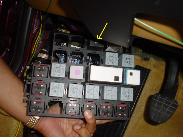

The first post was a picture of a panel with the blinker. Is it easy to access?

Courtesy of Part No.: 1HO 953 227 made in Tunisia (of all places!). $20.75 + tax. Not bad for a Porsche!
It was the blinker/emergency flasher relay (it has a big 191 stamped on the out side) under the dash.
As Toolpants indicated, the relay panel under the dash was easy to access. Plug and play!
Blinks like a mad man now!
Thanks all!. :cheers: Most honorable mention (and thanks) to Toolpants. :clapping:
