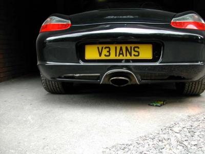

It will work. Ian on the UK Boxster board with a 2000 2.7 put a 2003 muffler on his car. He also put on a 2003 rear bumper cover and side vents, and is looking for a 2003 front bumper. I think he wants a 2003 part by part.
The 2003 muffler is identical for the 3.2 and 2.7. The only thing different is the single or dual tip, but the tip is held on with a bolt so you can use either tip. The Box muffler has always been stainless.
Ian's 2000 with the 2003 look. Jeff
Sorry about that this site is a little different to ours is the uk, Anyway Tool Pants PM me telling me off your plight so did a bit of research for you I spoke to the place where I bought the 03 exhaust from and he said that they had not tried it before on a boxster S ,but couldn't see why it would not work.this got me thinking when the car was first upgraded to the 03 bumper still had the 2000 model exhaust on will try and post the pic below, and the 03 exhaust was put on by a opc bodyshop couple of weeks later and went straight on,and believe me they would moaned if was not straight forward.

To translate what Ian said into Yankee English. He put the 2003 rear bumper cover on. He then put the 2003 muffler on for cosmetic reasons because it has a fatter exhaust tip. The picture I posted is the 2003 muffler. Ian's picture is when he still had his original 2000 muffler. You can see the tip on a 2003 muffler is larger. This is also true with the old and new S muffler with the dual tips.
