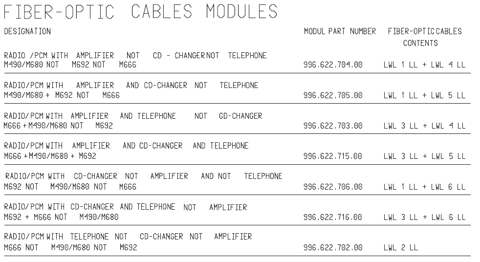

Did you get the right fiber optic cables for your cars previous configuration?

The fiber optic cables were the same ones from the cdr-23

You need the proper fiber optic cable(s) depending on your options.

I think the fiber cable is good as they managed to enable the unit, the standard one in the car should work ie radio/PCM with amp not cd changer and not telephone. The OBC enable I would like them to do anyhow and this maybe it.
