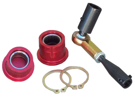

The special edition came standard with a "short shift." True this was done by reducing the height of the shift lever by about 1 inch - but I consider this method to still be a short shift. Porsche claimed a 15% reduction in shift throws for the special edition.
There are a dozen versions of a short shifts on the market these days.
You could even try the 997/987 version Porsche sells, but Porsche claims 20%. Your special edition is 15%. Problem is, you would not notice the 5% difference.
When I started Boxstering in 1999 there were only 2 short shifts on the market. Evo and B&M. At our local work on cars days we put in both depending on what the owner wanted.
I think it would be interesting to try the Evo swift shift with a special edition. The Evo unit is different from the rest on the market in that an extension piece is added to the bottom of the shift lever. This extension reduces the throws - Evo claims 20-30%. With the Evo unit you use your existing shift lever.
With the Evo unit you would have the existing 15% reduction, plus the additional 20-30% from the extension. Then, if you do not like it, you remove the extension and you are back to stock.
The shift knob on the special edition sits low compare to a normal car, with or without a short shift, since the special edition shift lever is 1 inch shorter. With the Evo unit you will retain the existing shift knob height.
I do not know of places in the UK for Evo products. Here is their US site. http://www.evoms.com/Splash.asp?nav=home&a...12%3A01%3A16+PM

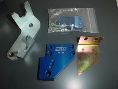

The other thought is the type of short shifter that bolts to the transmission. It is made by Ruf/Techart/B&M. This type of unit you can adjust the reduction of the throws. There are 3 settings. I forget the numbers, but it is something like 15%-30%. Like the Evo, if you did not like this type of unit then you just remove it and you are back to stock.
I've seen that kit listed for the 996 but not for the 986. Are there differences that would make it incompatible with the 986 like cable routing or clearances or something?
I take it you mean the kit that bolts to the transmission?
A long time ago I was going to buy one, from Brandywine. When I talked to the guy there were about 5 versions. I wrote down the part numbers but I do not know what I did with the paper. The 996 version was different than the Boxster version - that I remember for sure. I am a positive as I can be that for the Boxster there was a 5 or 6 speed version. I once looked on the B&M site but I could not find the unit that bolts to the transmission.
