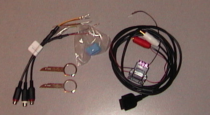

I did the becker auxiliary install last night. I did plug the RCA jack with an audio/power cable.
Basically it has the 2 RCA jacks that you hook up into the becker auxiliary cable but it has 2 other connexions one for power and one for the dock plug.

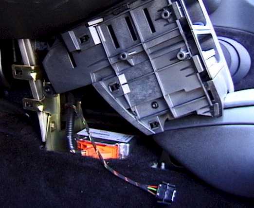

I found this picture on a V1 install it is a 1997 and mine is a 2000S so the harness might be different.
Is there an easy way where I could directly plug that harness into the power cable (black with purple plastic end) from the previous picture?

The phone harness is just laying in the back of the center console. To get at it just pull off the carpet cover on the side of the console. it is just held in with plastic clips.
On the phone power cable, the brown wire is ground, red/green is unswitched 12V+, and green/black is switched 12v+. Pick the power source line you want depending if you want power to the ipod all of the time or just with the key on. The wire taps just fit over the source wire, and the feeder wire sticks in one end, then when you close the clip it splices the two wires together for you.

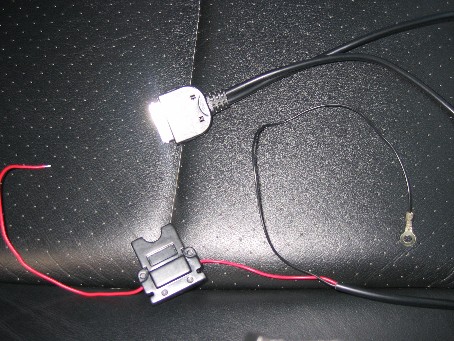

You should post a picture of the iPod cable, so I can see what it looks like.
Hello,
I already have the audio lines connected to the Becker cable.
This is what the ipod cable looks like (the sound is great but obviously it does not charge my ipod yet).
The cable on top is plugged on the ipod. At the bottom I have the connector and the red power cable and black ground cable, I assume?
So I should ignore the connector and plug the red cable to the green/black line on the phone harness and the black cable to the brown line on the phone harness.
Do you just twist them together and tape them up with electrical tape?

OK, very simple. Do you have the inline splice taps from Radio shack yet? If not go get them. Click here for info on these taps
On the red wire, the little black box on the wire is a fuse, leave that on, and trim the end of the wire so that there is no bare wire sticking out from the insulation. The red wire will go to the green black line on the phone harness.
On the black wire, clip off the terminal connector on its end, and splice that wire to the brown wire on the phone harness.
That is it. The only issue you may have is ground loop whine on the audio, and if you do, get the ground loop isolator cable from Radio Shack and place it between the iPod Audio cable and the Becker audio cable. Click here for info on the Ground Loop Isolator
Good luck with it.
