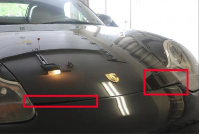

Guys, I buyed this car like that. I got a very good discount to repair by myself the front bumper... I'm tying to understand what's wrong, I need your inputs.
Look to att. picture. Centre hood is ok with the bumper, but both end are not and it looks to be symetrical on both sides. I will ask pricing to bodyshops around here to make the repair, but I would like to understand what is the problem prior to go and see anybody that would be able to repair my car?

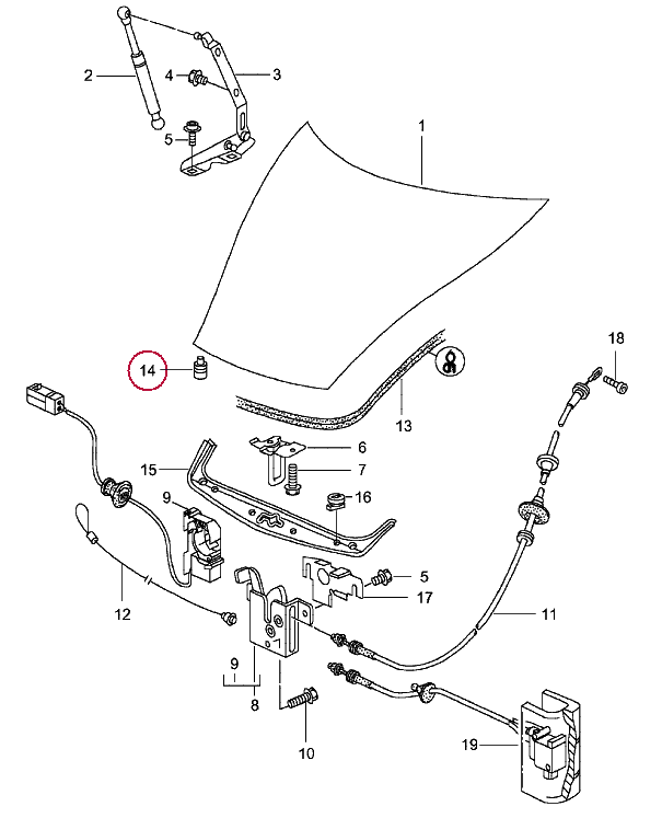

Item 14 is the hood bump stops (1 per side).
Try adjusting these first - I do not think I have ever seen them adjusted that bad so you may need to open the hood and take a pic of the corners.

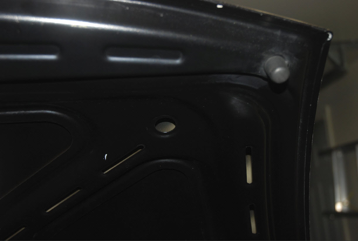

Item 14 are totally screwed. See add. pics if it can help...

- check/adjust (by screwing in to make shorter or out to make longer) the rubber stops in the front corners of the hood. Looks like the center is being pulled down while the edges are being stopped and bending upward. Is the trunk hard to open? Does is "spring" open (until the safety catch) when released? Try shortening them up a fair bit. Sorry no pics but look for the black (or could be oxidized/faded to white) rubber stops and turn accordingly.

Well then, as Loren asked, what's the bottom of your bumper cover look like? Sounds like, and somewhat looks like (based on your first picture - alignment of headlights to bumper cover) your front end/bumper was bottomed out pretty hard. You might be able to get everything lined up correctly by pulling the entire bumper cover off yourself and reinstalling.
Actually, looking at the picture + picture of the rubber stops, it looks like the center is too high. Good news is the bumper cover is made of pretty flexible plastic, so try to just take it off/loose and put it back on to see if you can get a better fit. Might actually have to adjust down the sides (turning the rubber stops to reduce their height) if they have been used to compensate for the misalignment.. The link Cassiebox provided has all the details you need to remove the bumper cover. Goodl uck! :)
