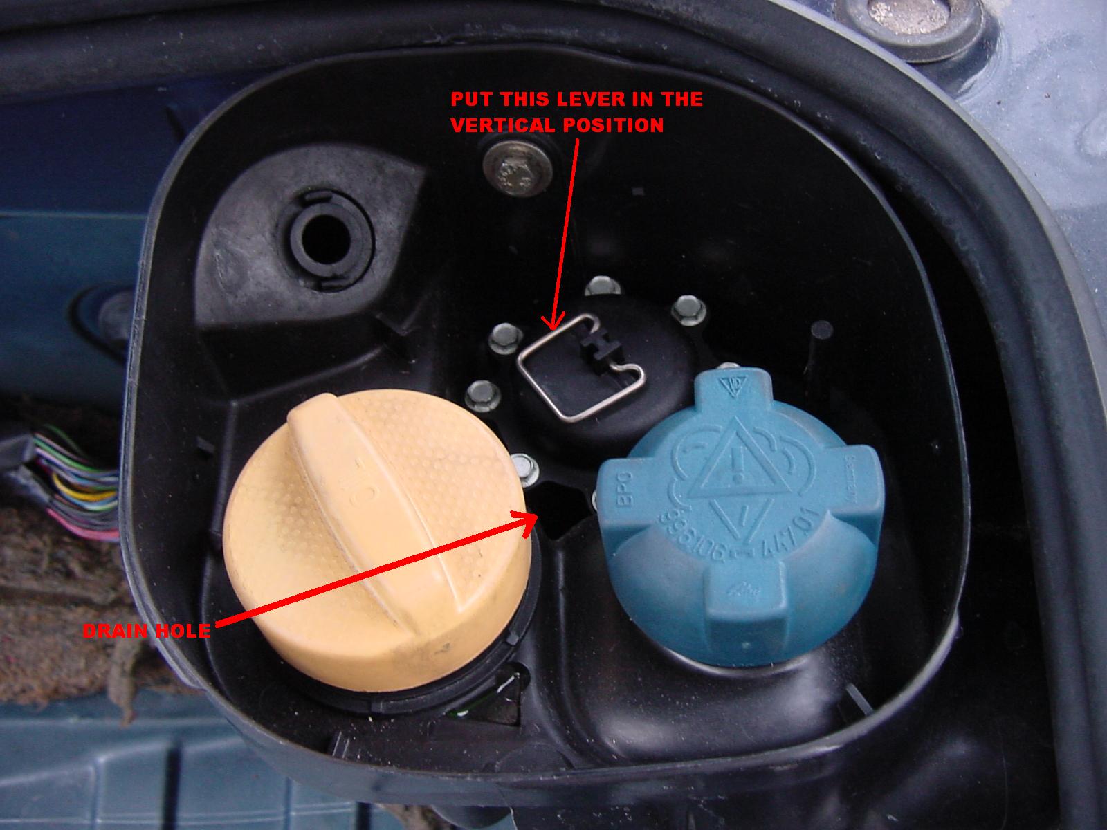

If the system was not filled by use of a vacuum tool, you will usually get one or two (or more) "coolant dumps" as the coolant overflows. Sometimes it's forceful enough to overflow the edges of the top of the coolant tank, other times it will just flow down the drain hole that is at about 9 O'clock to the left of the coolant cap and then exit down the drain hose which has its outlet just to the inside of the front of the right rear wheel.
You can help burp the system by driving around for a few days with the silver rectangular lever of the pressure relief valve in the vertical position (click on the photos to enlarge):

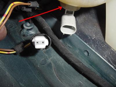

It wouldn't hurt to check the underside of your coolant tank for any coolant or caked-on coolant residue, in case the tank has a slight crack or the level sensor under there is leaking:

The level sensor can not leak Maurice, he has no contact with the cooling water.
  • 0

RFM:
Thanks for pointing that out. The coolant level sensor itself has no direct contact with the coolant, but the coolant tank can crack in that hidden area.

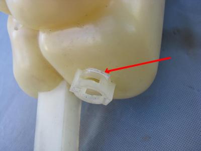

Here is a photo of one of my old coolant tanks that sprang a very tiny leak on the corner of the receptacle for the coolant level sensor:
- Zoom Active -
Regards, Maurice.

OK, i see what you meant Maurice, they still have some weaknesses after a certain number of cold/hot cycles.
