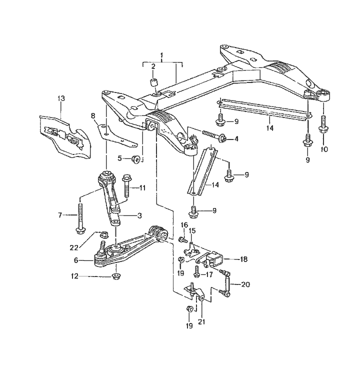

I thought it might be easy to spot. See if this helps ID the part you are looking for:
Hey JFP, thanks man. Do you have the part #'s that correspond to this diagram? I called a porsche dealer on the west coast (past business hours in boston) and described the bolt. He said he thought it was part # 90037832901. Trying to cross-reference that against your diagram might help me isolate.
Part # 90037832901 would be item #4 in the diagram.
Go to http://www.autoatlanta.com/ website, look up your model and you will find that diagram under the steering/front end section with the part numbers for each item. You can also find the same info if you have access to a Porsche PET. Good luck!

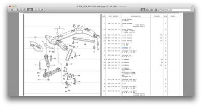

Thanks. Item # 4 does not look like the part. I think the bolt I am looking for is # 11. But I will print this out and take it to the car this morning and confirm.
FYI, I found these on Porsche.com also. http://www.porsche.com/all/media/pdf/originalparts/usa/996_USA_KATALOG.pdf
That is an online copy of the PET, which is their parts catalog.
It did turn out to be # 7. Special order from Porsche I have both on order. In the mean time I found a couple of M14x1.5x100 bolts at a local recycler. The #7 bolt I have on order are M14x1.5x110. I figured 10 mm shorter bolt should be ok for a few days to get me around till the Porsche bolts come in.

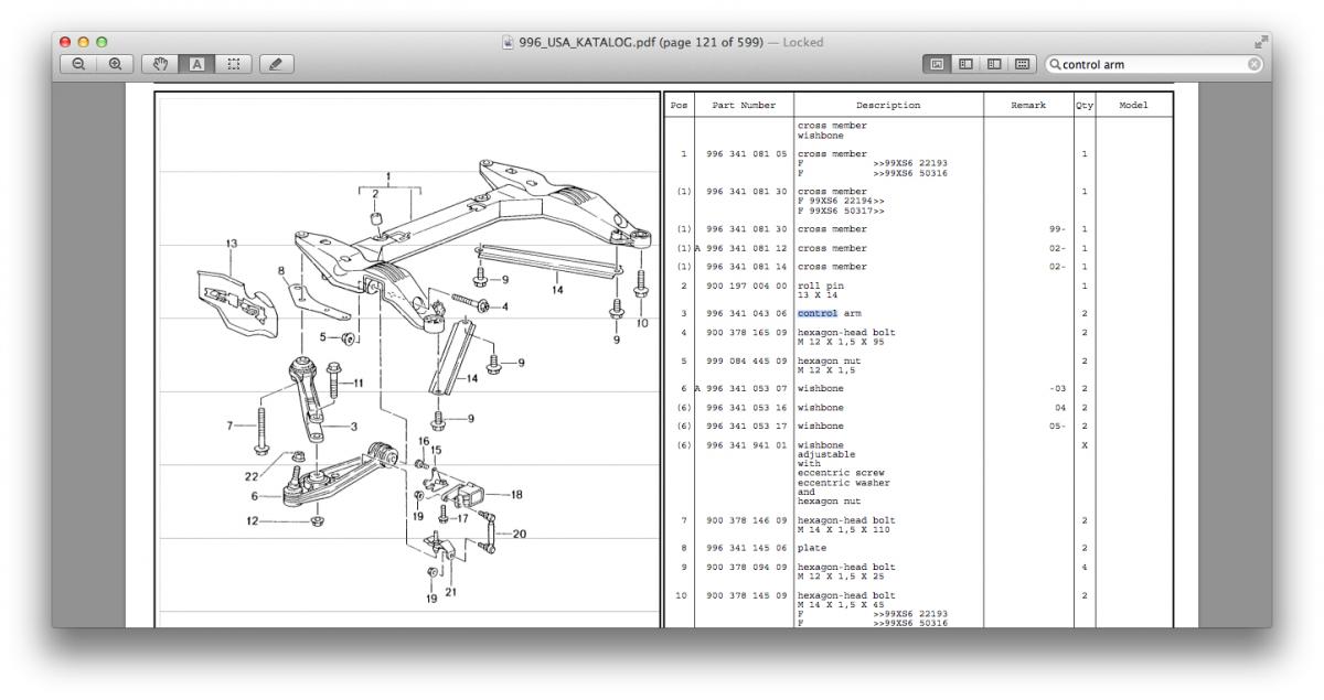

Thanks JFP. I think you and I are looking at different fiches for some reason. Here is what I am looking at from Porsche's website and shows #7 as a M14x1.5x110.
I was using the diagram in the Bentley manual; the PET should be more correct, although the bolt may also have been superseded, so I would stay with the PET. The torque spec (from the OEM service manual) is correct at 118 ft. lb.
Thanks. The dealer did confirm that the part # for 7 was superceded by a different number: 90037832901 which is what I have on order. So who knows, Porsche might have superceded the 110 bolt with a longer 160 bolt precisely to avoid what happened to me!
