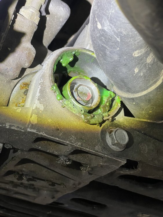

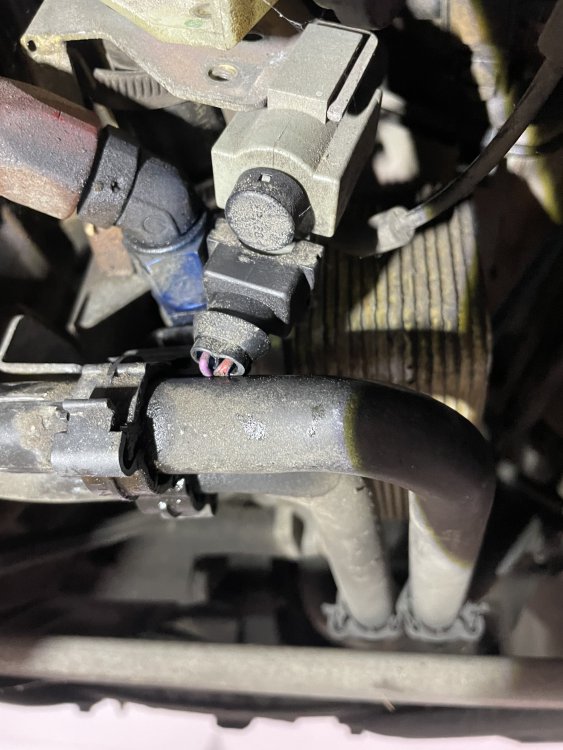

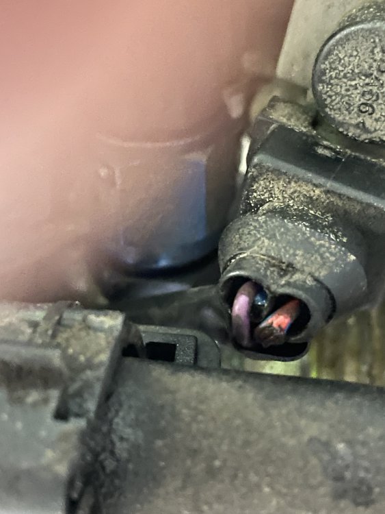

  2. FINALLY FIXED- First- Loren and JPFLIP, thank you for all of the advice over the years. This site has been an amazing resource. I am sad that a company with deeper pockets like Pelican Parts couldnt take over the forum and retain all of the fantastic information herein. That said, I want to give the final update on the GT3 issue and fix. Ultimately the car had gotten to the point that after warming up, the fuse would blow when starting from a stop. I got good at replacing a fuse in the middle of traffic the last time I drove it...After a new ECU and point to point shooting of all the wires, my Indy guy and I agreed it was time to drop the motor and comb through the wiring. Ultimately that wasn't needed. A few years ago, after the factory transmission mount disentegrated, I installed the Green Cantrell Motorsports Street Urethane mount. I never had any indication driving that there was an issue (clunking, etc) that it had failed. As the tech was de-paneling the underside of the GT3, he found the mount had failed and the resultant sag had a plug on the transmission case (Vacuum changeover valve for transmission cooler) resting on one of the coolant lines and had chafed one of the wires to bare metal resting on the pipe. the car would warm up and when the ECU/DME sent the signal to open up the valve for cooling - Boom. Repaired wire/plug and replaced mount and runs great. Still a little laggy at 2000 RPM but rest of range is lovely as always. Just wanted to get this in the system so that people with this fuse blowing aren't completely focused on the Variocam Solenoid wire which seems to be the "usual suspect". Pics to include. Thank you again for all of the effort and support for our enthusiast community.
