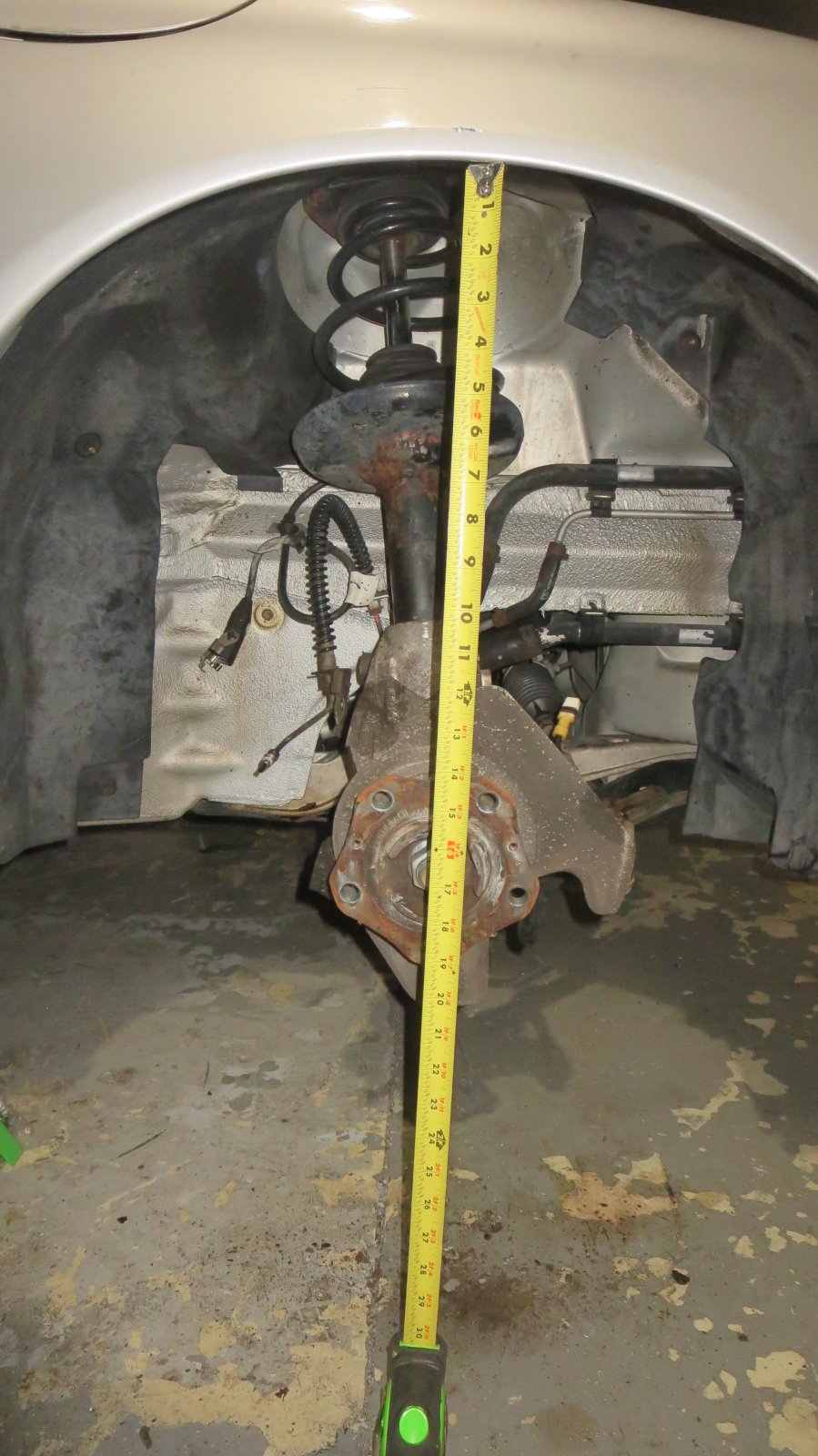

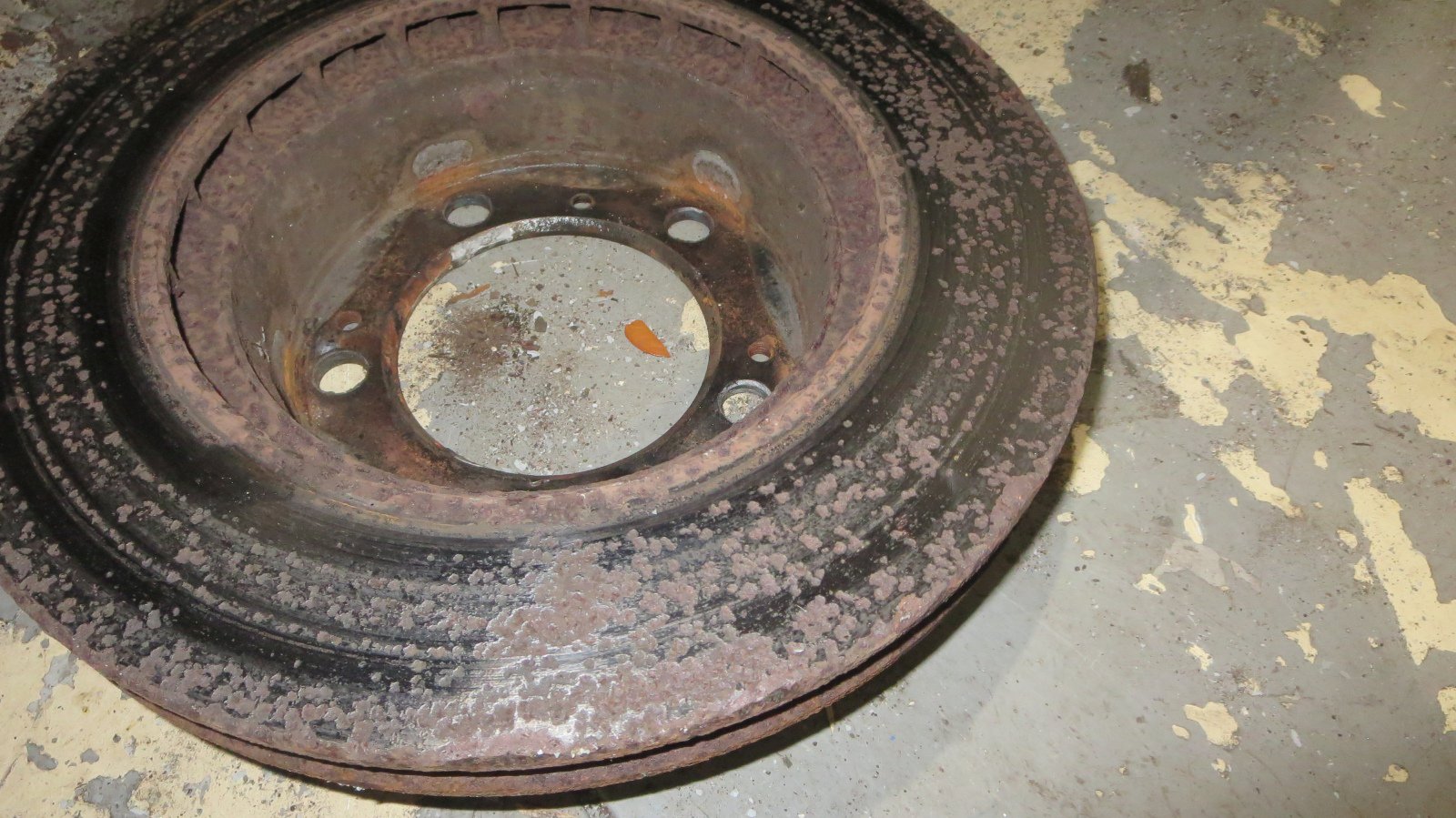

  2. Rotors are non-turnable for about the last 20 years. Has this car been sitting outside - that is a lot of heavy rust. The suspension bushings are likely dry and also cracked. I would replace them as you don't want any surprise failures. Suspension heights and distances have been covered here before - please try and search for them.

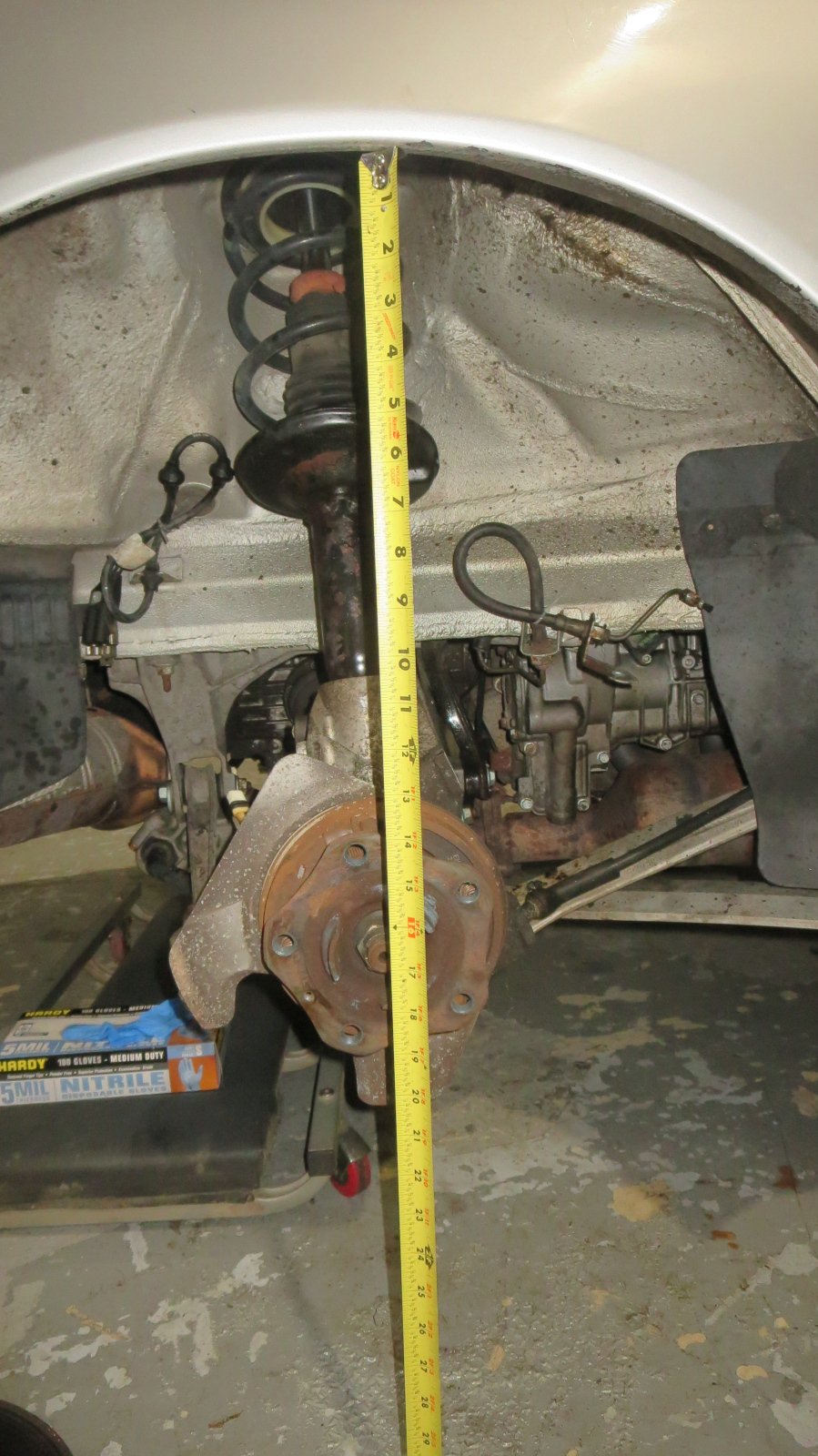

  4. A quick follow up... I'm replacing the caliper bolts... I'd rather stick to spec than not. Turns out the calipers are Brembos... their surface treatment, whatever it is, is impervious to paint stripper. The rattle can yellow is mostly off. My brake pads look like new.,.. I was surprised to see that someone would actually re-use the rotor shown in the picture.. it's 1.5mm above minimum thickness, but there's no way to have it surfaced that won't won't leave it under spec.. new rotors being installed around. Finally, I dummied out and failed to measure the distances from the inside of the fender openings to the middle of the wheels.. need those to set the empty weight ride height before tightening the inner lower control arm bolts, in order to lock that bushing in at the neutral position. If one of you has a stock base model Boxster, circa 1998-2004 (not lowered or anything in the suspension that changes that...) if you would be so kind to get those dimensions and share them in a reply, I'd really appreciate it. The ...360 picture shows the front, ...370 the rear. I happened to already have the wheels and rotors off when I took the pictures last night, but I'm thinking it should be obvious. thanks & have an excellent day!
