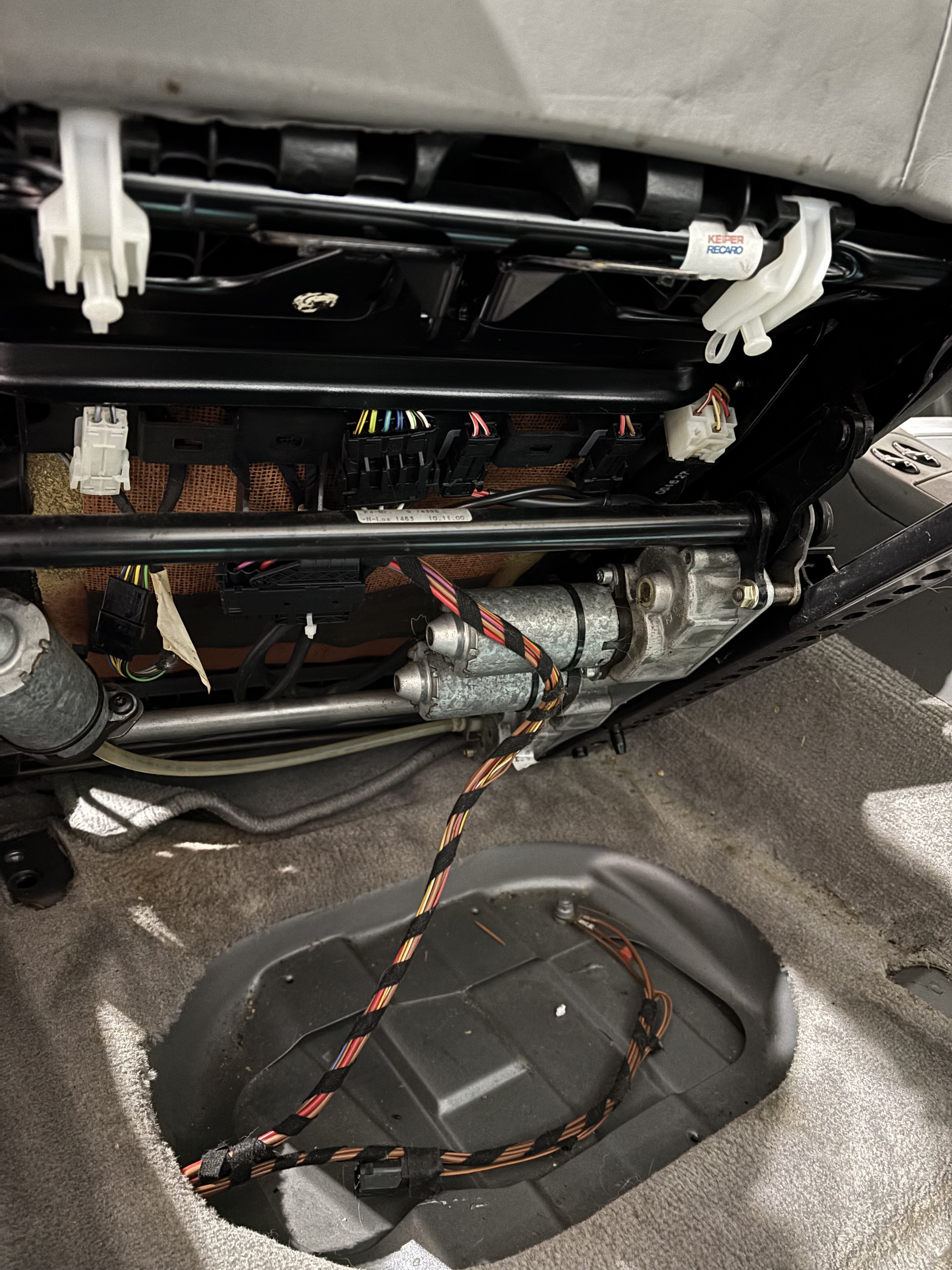

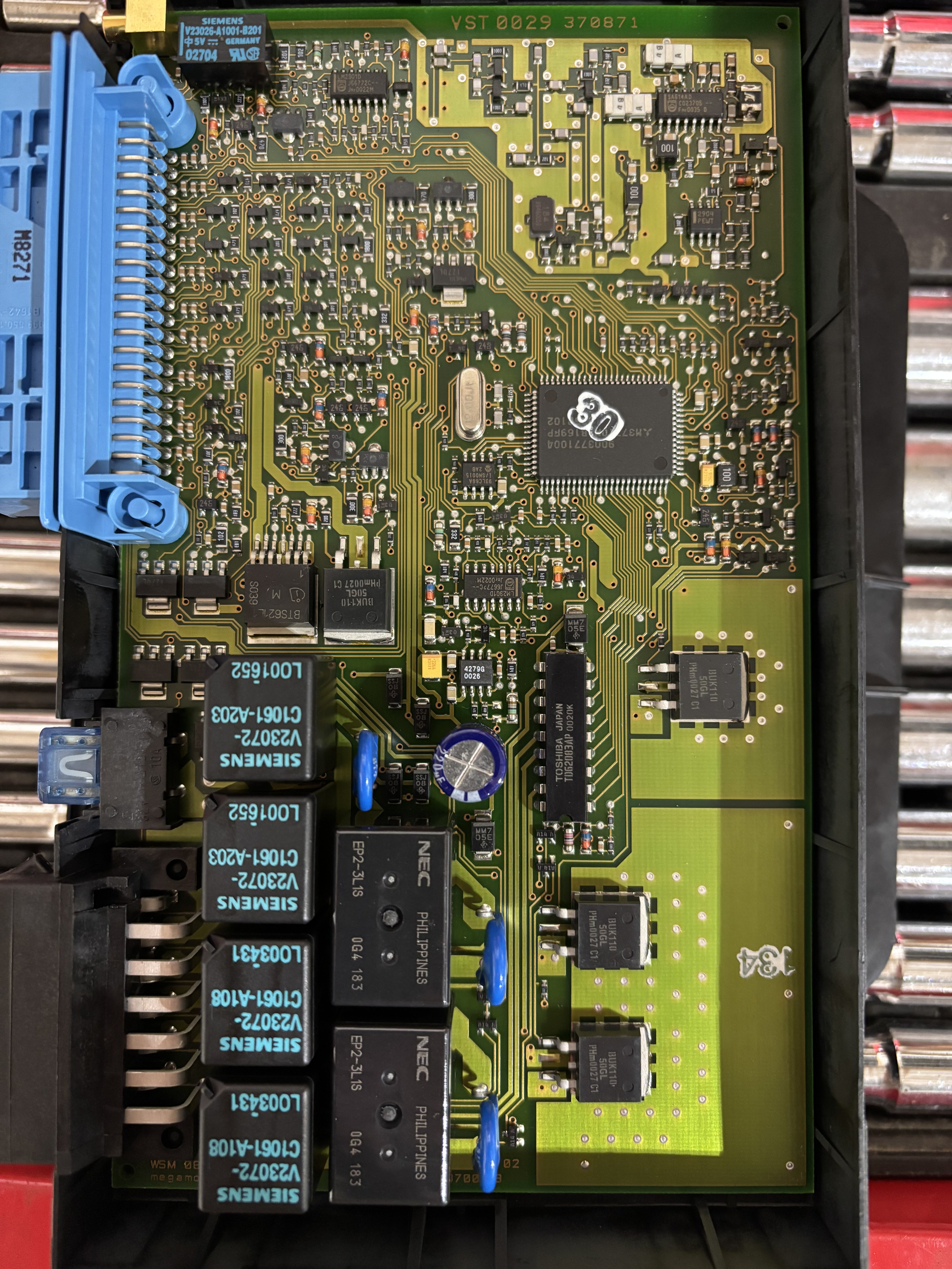

I checked the immobilizer box, but it was located under the driver’s seat. Under the passenger seat was just a point of contact for some grounded wires: . I did pull the immobilizer from under the driver’s seat and pulled it apart. It is perfectly clean: I also installed a new ignition switch. I knew that wasn’t going to help, but I figured I would mention it. To recap: Car does not start unless I install a jumper wire and bypass the relay. The battery is charged. There is no voltage drop between the battery and the post in the engine compartment. The ignition switch was replaced, but that was totally unnecessary. What’s next?

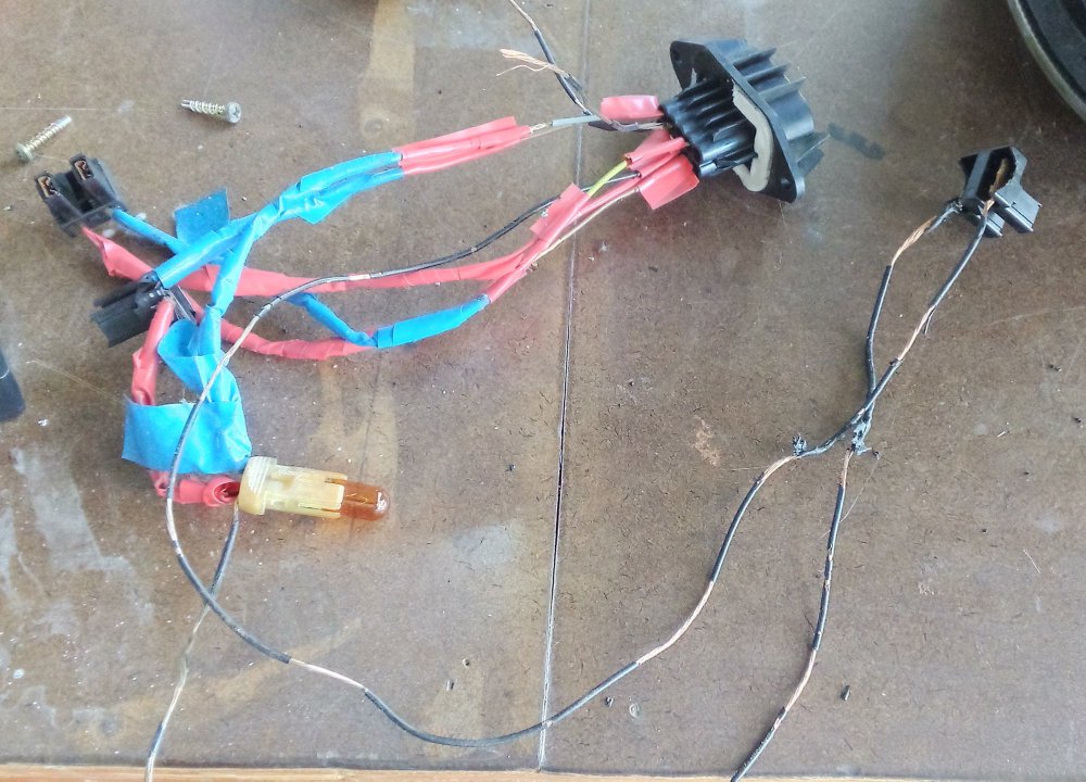

I'm having some problems with the headlights on our '97 986 and having pulled the assemblies out of the vehicle I found the wiring inside was dry brittle and crumbling. Lots of exposed copper, probably caused a short and damaged the lamps. I have been searching for a replacement loom but cannot find anything close. Everything I find seems to be the full harness that goes 'outside' of the headlight assembly, not the internal wiring. Any idea what name/terms to search for, and where to search. Everything I found was on ebay, nothing OEM new. For now I've tried to wrap in tape but worse comes to worse I will cut/splice and put new heat shrink over it all. Unless you guys have any better solutions. The lamps incidentally are aftermarket HID LEDs. I am going to try to replace with OEM bulbs for now. Only the high beam works right now Cheers
