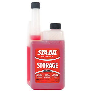

Current fuel blends, particularly with 10% ethanol in them, can degrade pretty quickly.  StaBil makes inexpensive additives that can stabilize ethanol blended fuels for up to two years.  Worth a look, we use their "Storage" product on all vehicles put up for the winter here, and have never had one act up in the spring.
