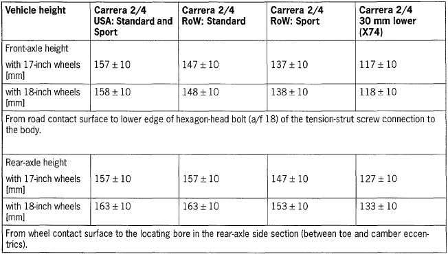

I would start by comparing the alignment specs and ride heights (see below):
Carrera
GT3

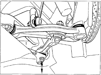

hey Loren,
what do they mean by "From wheel contact surface to the locating bore in the rear-axle side section", where is, do you have a pic to make it clearer for me?

Front Axle Measurement
Rear Axle Measurment
