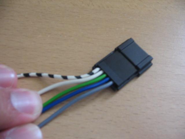

When we make the harness for the OBC stalk we use 5 wires. Slot 1 on the stalk connector is the ground wire, and slots 2-5 go to the cluster connector. There is a 6th slot in the stalk connector but we do not use it as there is no wire in this slot.
Here is a picture of the OBC stalk connector and you can see there are just 5 wires, and an unused slot. But Loren's diagram shows a 6th wire, A6 is the 6th wire. All the slots are used on Loren's diagram.
Every OBC retrofit I have done the stalk connector had 5 wires, not 6, but Loren's diagram shows 6. Then there is the instrument cluster connector with a wire in slot C25, which I guess would be for a 6th wire from the stalk connector. So I am seeing 6 wires being used with the dot matrix cluster. On paper at least.
But if you look at PET there is only one OBC stalk listed. As I said other people have put in the dot matrix cluster and there was no need for a 6th wire. But those people used the stalk, not a switch, and I don't know if that is the cause of your issue.
So, slot C5-lever inside on the cluster connector and slot A6 on the stalk connector are a mystery to me. All I know at this time is it is shown on the wiring diagrams.

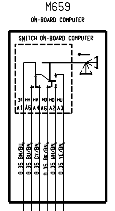

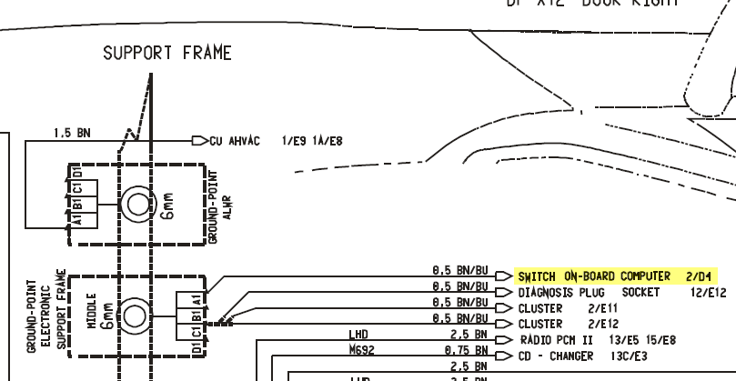

Loren are you saying that I need to have 6 cables coming from the stalk harness?
I understand lever right, left, front and rear, but what is meant by the description "Lever Inside". I don't have a switch on the end of the stalk and can't push it in.
The factory wiring diagrams are wrong, there is no 'lever inside' connection. As Loren states, A1 goes from the stalk to ground, the other wires go to the cluster from the stalk.
-Todd
