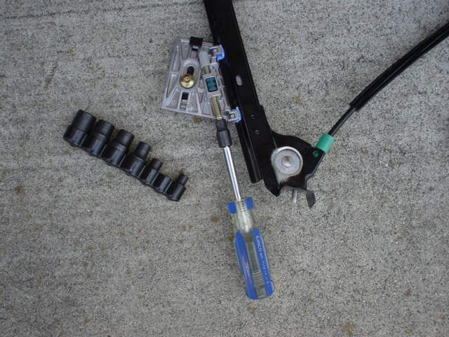

I have never done this but I have an extra regulator and I played around with it a few months ago to see how it works.
There is a clamp on each side of the regulator for the glass. By adjusting the height of the clamp you adjust the height of the glass. Each clamp has a male torx screw to adjust the height.
There are 2 round oval rubber plugs at the bottom of the door. Those plugs must be for adjusting the height with a tool through the opening. You can see my E7 female torx driver in the picture and it is on the screw. My regulator is an E7, not an E6 like the shop manual says.
I probably will try both.. using the gel and adjusting the regulator. The picture provided by guru is quite clear. I couldn't tell what it is from the shop manual.
