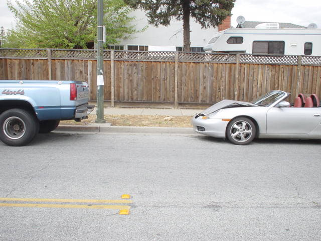

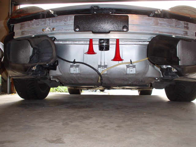

Not to negate your efforts, but this might be a good time to upgrade your horn. I found the OEM horn to be very timid, and unlikely to get the attention of, say, a truck backing into you (ask me how I know!). On the recommendation of someone on this board I bought an Italian air-horn from Griots ($39 or so) and it made a world of difference. The install should be a cinch for you by now!
That is "sound" advice! Someone backed into my 996 when I had the horns blaring, and I immediately ran out and got the Griots horn. There is no chance that someone will not notice me the next time.
