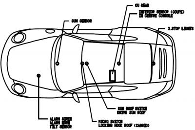

  17. They can only be reset with a PST2 or PIWIS tester. 33 - no passenger compartment monitoring -- Replace passenger compartment monitoring sensor. 60 - central locking limit position locked not reached -- Possible cause of fault - Central locking switch faulty - Short circuit to ground/open circuit in wiring between the alarm system control module, central locking switch or door locks - Driver's/passenger's door lock faulty - Control module faulty Most of the troubleshooting tests for fault 60 require more alarm tests using a PST2 or PIWIS tester. I would not replace that fault 33 passenger compartment monitoring sensor until the tests are run as you could have a bad control module.

  19. 996 612 978 00 is the just wiring for the PSE switch (not the rest of the PSE).
