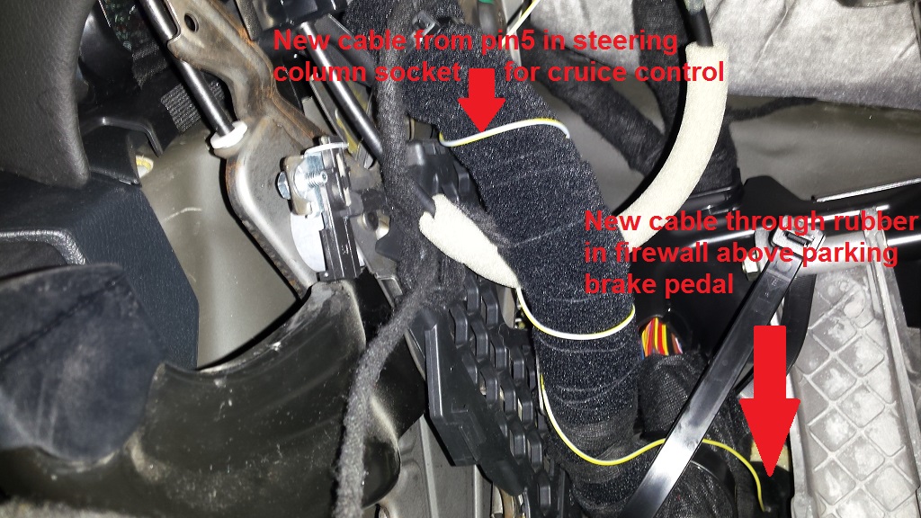

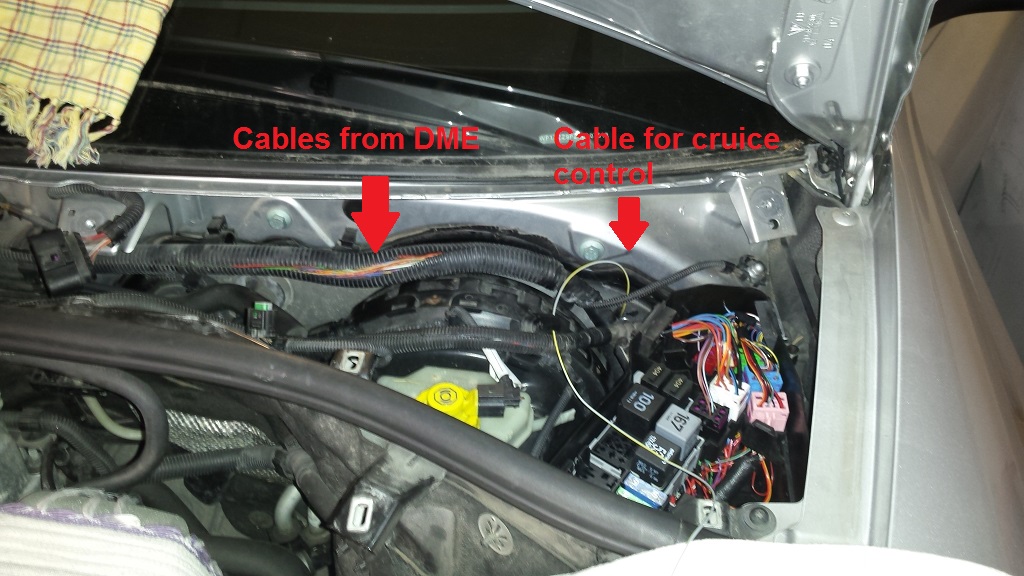

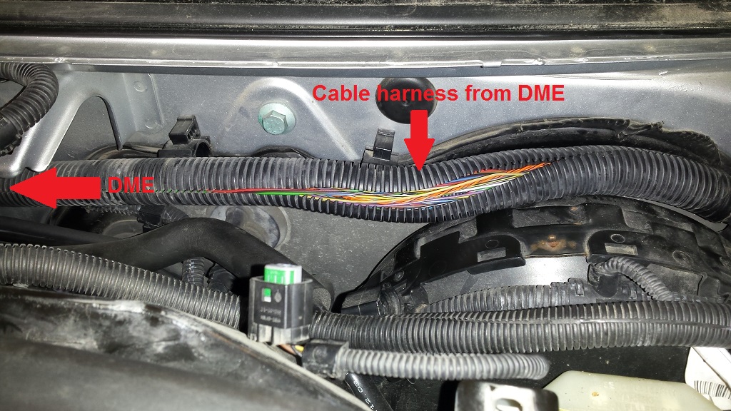

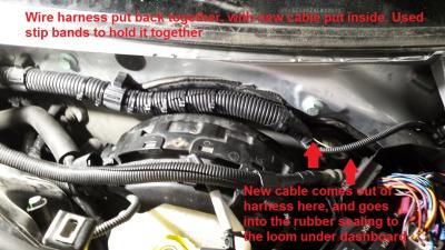

  7. Did you look at my pictures? Wire should be between pin just below stalk (a few centimeters, you will see the connector). Make a hole in rubber sealing in torpedo wall so you get the other end of cable to engine room (wiper-area). DME is on other side of engine room, so you need to get the cable to the other side. Or do as I did, find the correct wire and solder them together on drivers side.

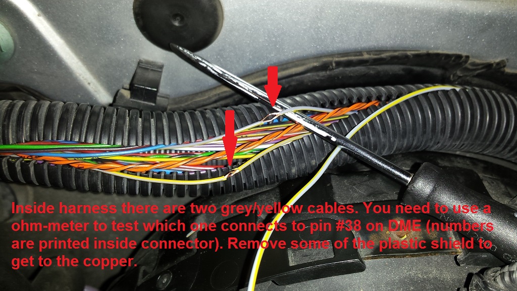

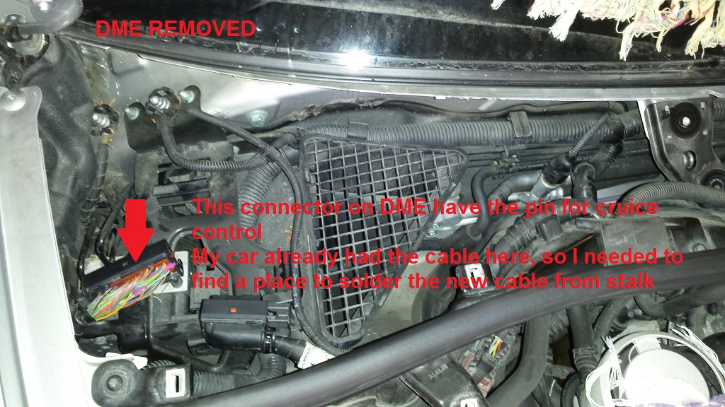

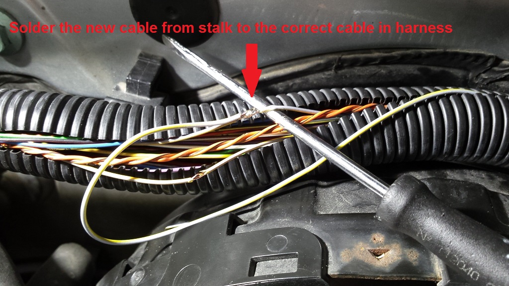

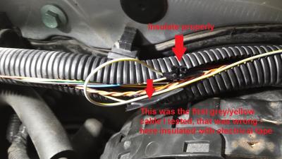

  10. Cables in harness, open it with a little force with your hands. DME removed, 2 big connectors below. The one to left is where pin A#38 is located. If you look inside the connector there are very tiny numbers with pin numbers. Locate #38. If cable is missing, you must connect the new cable here. In my car, the cable is in place (yellow/grey) There are two grey/yellow cables inside harness, we need to find the correct one. Use an ohm-meter to do this, use a thin needle in pin A#38 on DME-connector to get connection during this test. Remove a bit if the cable shielding to access the copper. I missed, so I succeeded on the second cable. Solder the new cable from stalk to the correct cable that goes to pin A#38 Insulate properly! Next part now is to program the car to activate Cruise Control. I have ordered cable and software from China, but that is probably only for reading, not programming. Maybe I need to drive to Porsche and let them activate it with PIWIS. Lets see how it goes. My goal is to do this as cheap as possible!

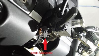

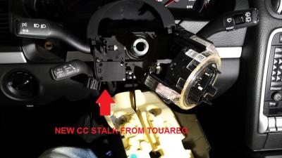

  11. Managed to connect stalk and the cable to DME :thumbup: Here is how (sorry for my bad english) : Bought a Cruise Control stalk for VW Touareg on Ebay from Poland (about $20 - I'm from Norway, but convert to $ for you here) Bought this directly from Porsche for about $15 : 955 044 903 01 - wiring harness N 103 357 01 - pin 999 650 135 22 - contact bush N 909 068 01 - torx screws - (2 PCs!) N 910 207 01 - screw Total about $35 :king: FOLLOW THIS GREAT DIY FOR FITTING THE CRUISE CONTROL STALK : http://www.jackals-forge.com/lotus/cayenne/cruise/cruise.htm USE THIS GUIDE FOR REMOVING AIRBAG (better description than above) http://rennlist.com/forums/porsche-cayenne-forum/784624-pics-on-how-to-remove-steering-airbag-955-a.html For the cabling, this is what I did : New stalk for Touareg fitted Stalk connector where you must find pin #5 Stalk connector with pin numbers printed Release the smaller connector inside the big connector. Pin numbers are printed. Make cable ready with pin, and insert it to #5 Remove trim under dashboard above pedals. Easy, only 1 screw and plug for light and ODB-port Secure the new cable "under there" so it will not get loose or something. I lay it round a thick cable harness. Inside there, above the parking brake pedal, almost as high as the mirror, there is a big rubber seal that cable harness goes through. Stick a sharp metal "thing" through the top to make a small hole for the cable (I taped the cable to the metal "thing" and drag both through the new hole. This is from engine room, next to fuse box. You see the cable come through the rubber sealing. I opened the cable harness from DME, you see all the cables inside there. To the right in picture you see the new cable from Cruise Control stalk (Pin #5). I removed the lid on fuse box to get more access, but you probably manage without doing that also. Continue in next post.....
