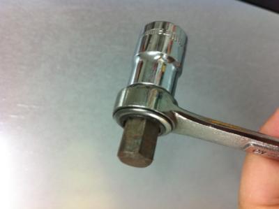

  23. This is what I used. A combination wrench with an allen socket. As I recall it was a 10mm size? The allen is the same as a tripple square but has half as many teeth so you need to be gentle with it. I think I might have even used a pipe cheater bar to get some leverage on it. (yes, I know, bad protocol, but when the transmision is hanging there, theres no time to wait 2 weeks for a special order socket.)
  24. I recall the same problem when I removed my gearbox. Because its a triple square you can gently use an allen bit to remove it. The catch, as I recall was that the space is too tight for the socket wrench to get into it with the socket. I simply put a combination wench around the bit and slipped it into the bolt. It easily removed the bolt. -k
