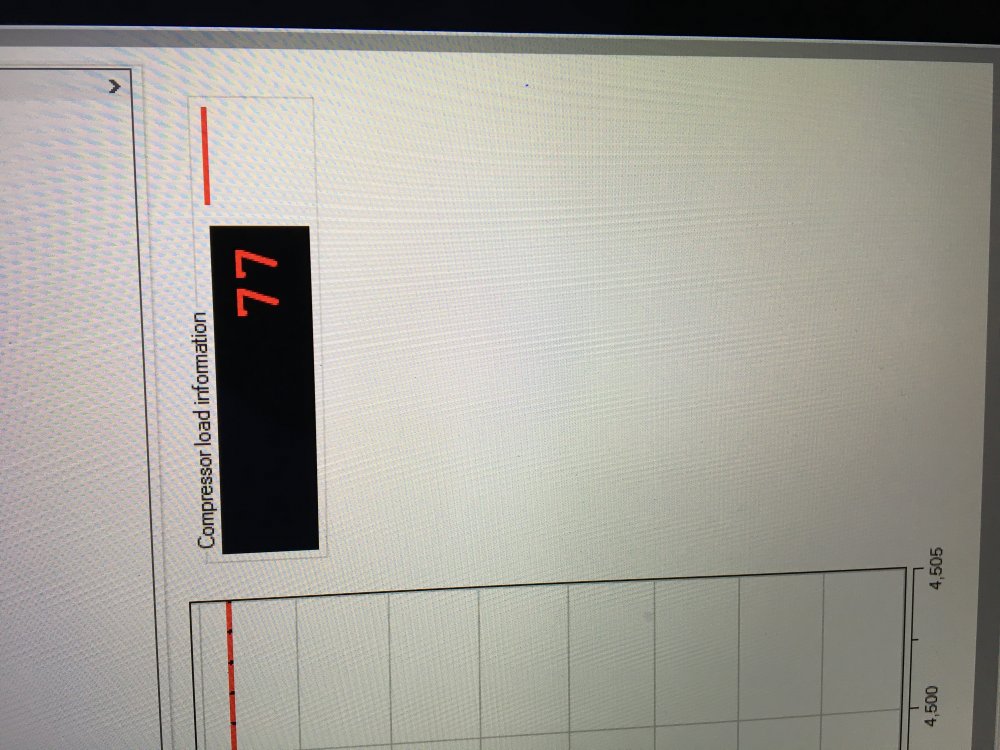

  3. Here are my current readings, any opinion?
