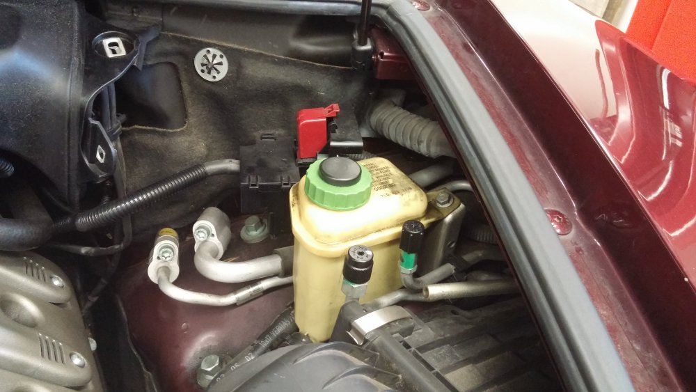

  23. UPDATE on the wrong-reservoir gaffe: After a bit of reading on RennList I found a description of a power steering bleeding procedure on an early Porsche. It looked pretty simple, so I backed out a low-lying fitting on the steering rack, drained all I could get of the contaminated fluid out of the system with the help of a brake bleeding pump, rinsed it with ATF, drained that as well as I could, and then added 1.25 litres of VW/Audi power steering fluid. It's significantly thinner than ATF. While I had the covers off I changed the oil, filter, and the front diff oil. The fresh fluids and soft winter tires seem to have reduced rolling noise in the cabin, and the steering is considerably lighter. Before my dumb error, sharp low speed turns took quite a bit of arm strength. They seem easier now. Maybe I was due for a PS flush anyway. No fluids have appeared so far on the garage floor.
  24. Perhaps a ring around the cap came adrift over time, or the cap is a generic replacement.
