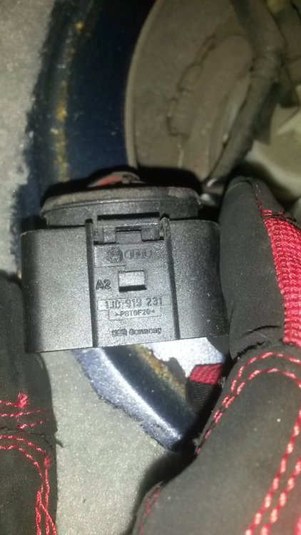

  6. To remove the white plastic part on the headlight harness (#19 left side), you have to pinch the tops of the connector toward the center and wiggle it free from the plastic tray. It is also connected to the wiring on the other side via a socket (#19 right side). I removed beauty covers from under the hood and opened the air filter housing on mine to gain more access to the space, but mine is a 955 Base V-6, so yours may have a different layout. I also had to use a file to shave some of the plastic tab on the underside of the headlight to gain the leverage needed to seat it all the way back into the newly installed headlight harness using the headlight tool.
  7. That part is 1J0 919 231. It is a VW/Audi part and you can see if any local dealerships carry it in stock. I had to get mine online.
