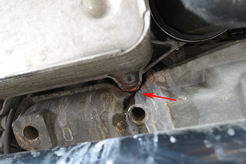

  1. Loaded the kids in the car to go hiking and then saw a puddle of coolant under the front of the engine. Constant drips, red arrow in the picture but actually come off the engine ahead of that, at around the blue arrow, under the sway bar. Can’t see anything wet from the top, but can’t see much in general. Can’t see from the bottom either, and it looks like I have to take the oil cooler off (or whatever the box the oil filter is attached to is). Any guesses what this might be - water pump I’m figuring? If so what is the best way to see this area, from the bottom or top? **** it... Thanks. Edit - here is a better picture of where it is actually dripping from, right at the front of the oil pan.

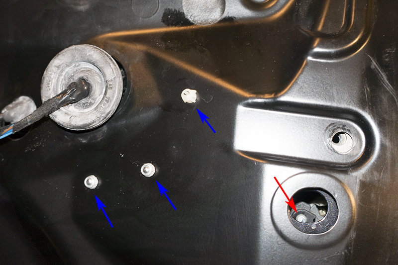

  3. I found mine had several rivets in addition to the 5 that are usually shown. This is from the Passenger Front Window thread below. I had to drill out the bottom two blue ones in addition to the 5, they were attached to a plastic guard which is attached to the other side.
