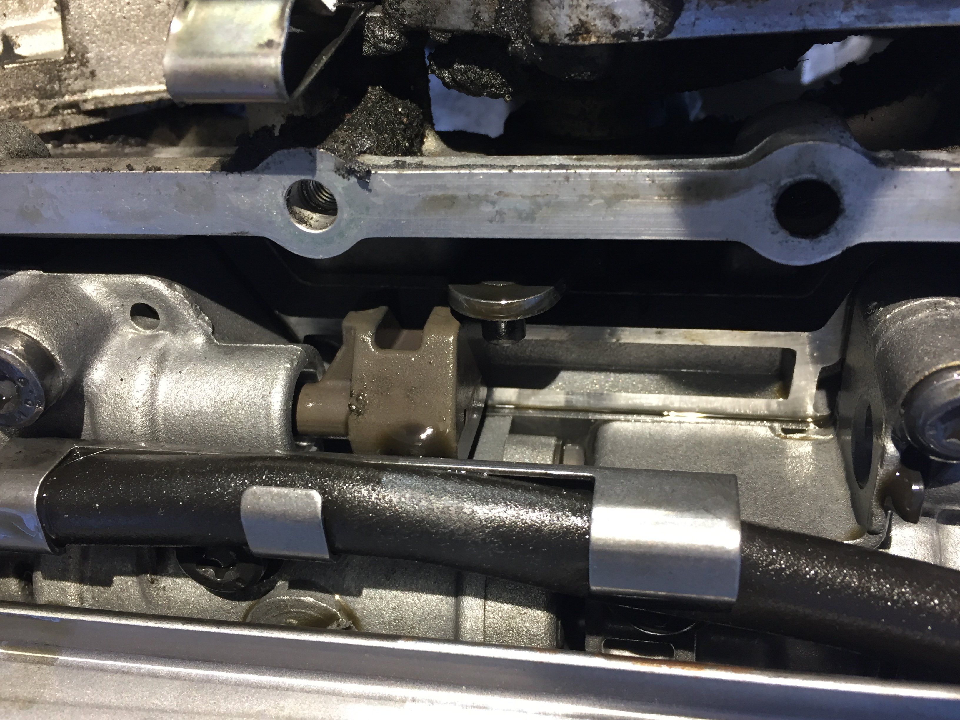

  15. I think I found my issue....... When I reinstalled the valve body, I neglected to make sure the selector tab was inserted into the piston. I hate removing things and reinstalling because I was stupid!
  16. Had to remove the tiptronic to replace the trans oil pump and torque converter. Naturally, this involved removing a lot of the guts of the transmission. All seemed to go back into place with ease. The transmission is back in the car and electronic connectors back in place. However, when I tried to put the cable back on the shift knob ON THE TRANSMISSION, with the gear selector in PARK, the end of the cable was off, because the transmission shift selector would not move into the PARK position. The furthest back it would go is REVERSE. The position of the transmission was verified by the indicator on the dash readout. In Reverse, the two ends lines up perfectly and they did in neutral. If I connect the cable to the transmission mounting point, the gear selector will not go into park, because the shifting mechanism on the transmission is preventing it. I did did not remove the shifting mechanism on the transmission, nor did I mess with the shift cable or gear shift in the car. What would prevent the gear shifting mechanism (on the transmission) from being manually into the park position?

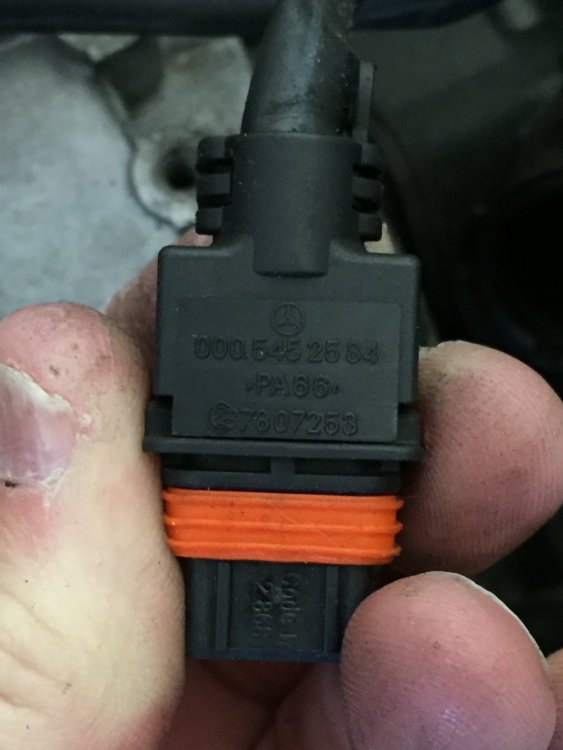

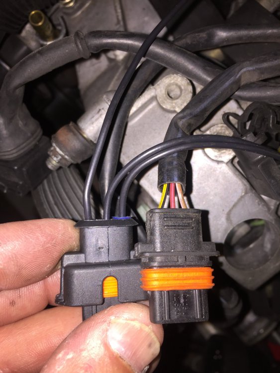

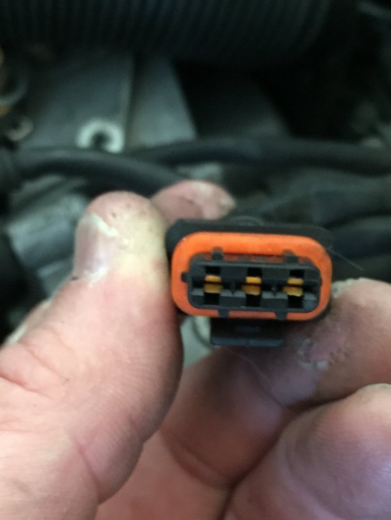

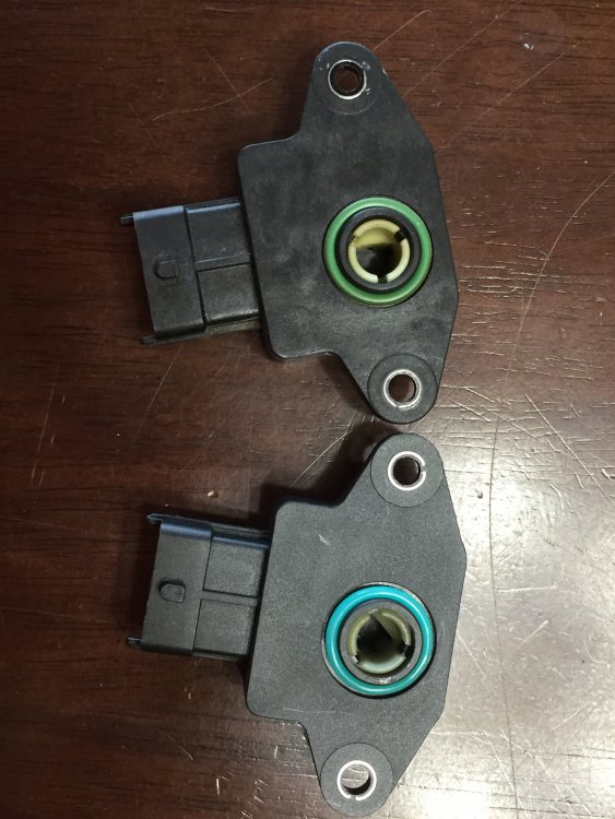

  17. In an attempt to find a “plug and play” solution, I found what looks to be an EXACT match for the TPS and connector. I ordered one and it came in today. Both the TPS and connector was about $11. I figured worst case scenario, I would replace the TPS and then becassured of a connector that fit. The outside look a little different. End view of connectors looks to be exact match And the two TPS sockets look exactly alike. Even the part that connects to the Throttle Body looks the same.
  18. 3 wires/3pins The BOSCH part number on the outside of the TPS doesn’t come with a connector anywhere that I can find. Amazon showed one, but it wrong. It isn’t for the right TPS connector that I need. 0 280 122 016 - TPS 000 545 25 84 - number on correct connector (no luck)

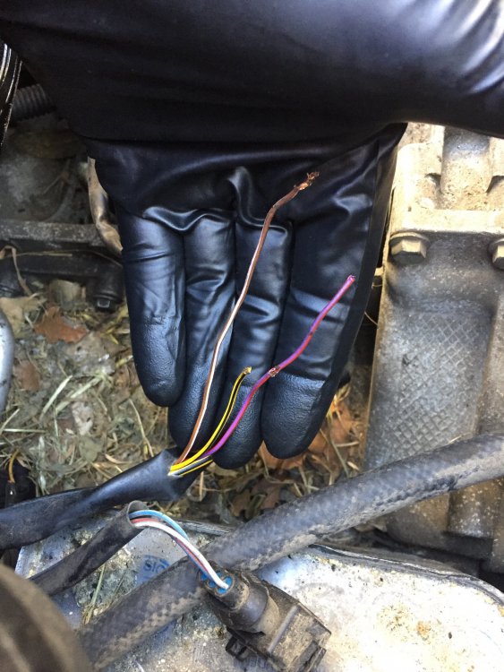

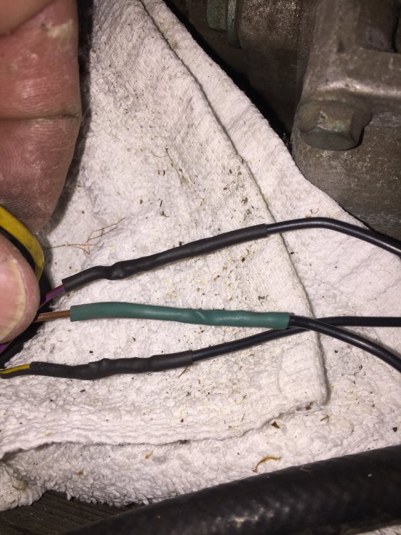

  19. Looks like on my project Boxster, a CEL (code P0123) is caused by a rodent chewing through some wires. The project car is a ‘97 Manual. Does anyone have a part number for the connector that plugs into the TPS, or know where I can find one to splice in? The Bosch part # for the TPS is 0280122016 Thanks,
