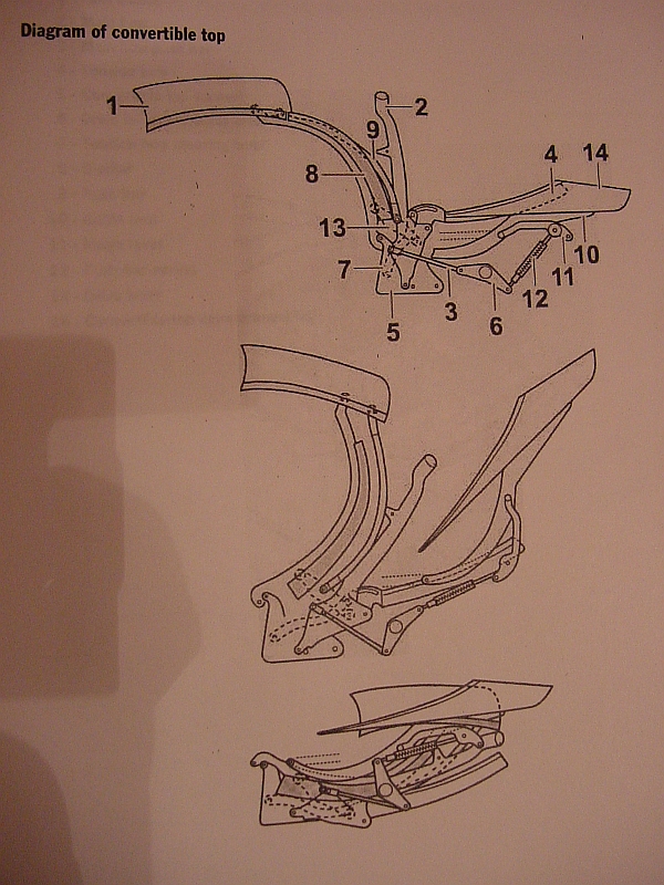

  11. Wa Hoo ... :clapping: :cheers: Finally with the Informations I get from the helpful forums, I manage to get my Top work wonderfully in Electric Mode. Keep :beer: finger cross .... Thank you all for the wonderful help & information ... I salute to all ... :notworthy: With the Helpful Information I get on Title : Conv top R&R, The Saga Of One Messed Up Top & How to manually lowering convertible top ... :drive: safe & smile on your face ... :lol:
  12. Hi, TQ for the feedback. The electric mode Top is keep giving me problems, at first, it is the open un-evenly problem. After the Weekend DIY, check on the cable things, I have DIY for the cable to 3/4' sticky out. For a while, the top was operated well in electric mode --> was Happy :thumbup: Then out of the blue, after I un-latch the microswitch, & press the buttom --> Nothing happens, the clamshell do not go up. Hand brake light is on. It just die off on me, quite :censored: & blur .. :cursing: ... So thinking of other alternative to set the top in manual mode, or more like "1/2 electric, 1/2 manual" mode ... But first I need to fit the Black Hydraulic pushrods .... to operated in elctric mode ... :( Will feedback the result over the Weekend DIY ... Appreciate all feedback ...
  13. :welcome: I have one question :- Could we have the Convertible Top set to Manual ??? By taking off the Black hydraulic pushrod part #12 (by un-clip the pin), and the white (or red) plastic cup is located on the forward end of part #3. The Convertible Top Frame can be secure with Top Lock Microswitch, However the clamshell is a bit tricky --> how to secure it :oops: With the electric mode, the clamshell is secure by the Black Hydraulic Pushrod, But Manual ???? :help: needed ... anyone have any ideas ??? Thank you, I intend to manually open my convertible top as the Electric Mode give me lots of headache :soapbox: Appreciate any help ... :thumbup:
  14. Hi, Finally I manage to manually lowering my top by loose up all the Black hydraulic pushrod part #12 (by un-clip the pin), and the white (or red) plastic cup is located on the forward end of part #3 as attach photo, Thank to the Informative & helpful forums member. I try to turn my V-Lever Part #6, it only turn a bit & stuck there like clockwise from 3 to 8, then stuck ... Could the problem come from there ... what is the normal movement or turning circle of V-Lever ??? 180 or 270 degree turn .... Appreciate any feedback .... TQ :P
