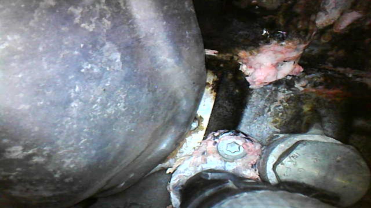

  5. Well. I have the manifold loose. I can't seem to get the fuel pressure sensor plug off the sensor. That may be what is keeping it from coming loose. Any ideas how to take it off? I'll try to post pics .. almost got this off..

  7. Well, I joined the party... I've tried to replace the membrane as well without success. I couldn't get to the last triple square, and maybe somewhat stripped the middle one. I may attempt it again with moving the coolant hoses.. If not, I'll be taking it to the dealership for the valve cover install. I have no codes, but the whistling seems to be getting worse. I like the 957, but this job is a pain for sure, gone are the days of Autozone 10.00 PCV valve pulled from the top of valve cover, 2 min install..
