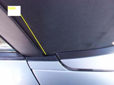

  21. Thanks for the link that's very useful. When you wash the car water goes through the hole in the picture. This hole is part of the Boxster design. Then the water goes through the drain point. In my case, the water was going theough the other man made hole and directly under the driver's seat. You guys better check your Pan/Water Drip for holes specially on the driver's side, trust me you don't want to go through the same thing I went through.

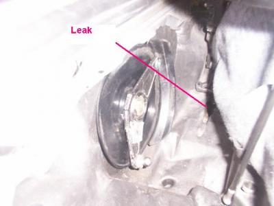

  22. This is an old picture of my transmission. Few months back I had so much water under the driver's seat which resulted in the burn out of my central locking system unit. After $2k+ of repairs, water still leaked. Porsche never fixed the leak. I checked under the seat few weeks after the repairs and there was fresh water under there. I couldn't figure out where it was coming from at the time. So I started outting towels under there to soak the water. A month ago I found the source of the leak. The arrow in the picture is pointing at this material (what is it called?). It has a hole in it. When ever I wash the car, the water , which is supposed to go through the drain point, goes through that hole and under my seat. I put some of that Blue Omega stuff that seals. But still water leaks but not as much as before. Does anyone know how to replace this material? P.S: the material I'm refering to is called a Pan/Water Drip. Part # 986 561 805 03
