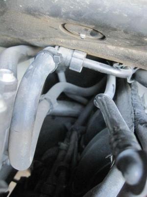

  1. Dropped the car off at the dealership for a new coolant expansion tank and asked them to ID the line and figure out if it needs to be replaced. Didn't have time for an in-depth discussion when I picked it up, but to summarize... 1) It is a fuel line (I didn't get the part number) 2) The part splitting is a rubber sheath protecting the fuel line 3) The fuel line was borescoped and found to be in perfect condition. 4) The car is safe to drive as-is I've filled the splits with Seal-All and zip-tied for reinforcement. Thanks for all the input.

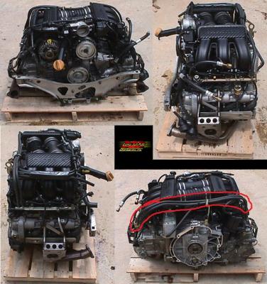

  2. Found this pic of a 3.4L motor... I circled two lines that pass over the intake manifold, the same as where I think the mystery line is going...
  3. Clipped the zip tie and tried to disconnect line to check what was inside, but it was not cooperating. It seems to have a permanent connection to the elbow and the elbow 'looks' like it is a compression fitting on to the metal line. Snapped another photo. The rubber portion is clipped to the side of the coolant expansion tank, runs towards the front of the car, then up over the manifold. The metal line. The metal line is clipped to the top of the compartment and runs straight forward to the front of the car, where I lose it at a second clip.
