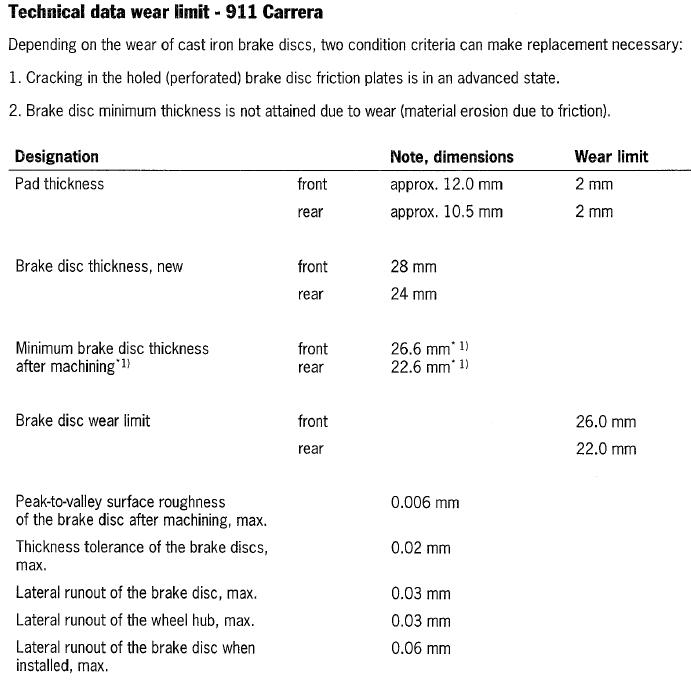

  14. see attached. 2mm wear is what porsche recommended. I did get this pic from another post in this forum, per Loren's. Check "replacing brake pads in the DIY section. From info in some other sites, you could use your rotors a bit longer if they are not cracked and you have to, as long as you do not brake hard (less thickness = less heat dissipation.

  16. you can get aftermarket pads at www.pelicanparts.com, ex oem supplier so basically same thing than textar which is oem. difference is around $85 for rear textar pads vs around $53 for alternative. rotors, not bad there, but maybe better deal at www.suncoast.com http://e-partssales.com/Merchant2/merchant...96BrakesCarrera or at shttp://www.sunsetimports.com/ usually very very inexpensive, but dont know if they have aftermarket. those 3 places. compare shipping and such and very quickly you'll have best price. I had to take care of my rear brakes a couple of weeks ago. I did skip changing rotors, they were worn down 2 mm thus I should change. but tight budget and for now, I just changed the pads. Unless you drive hard, the rotors cool down fine as long as there are no cracks of course.
  17. Yes, I am changing pads or I know that it will be bad. Fronts have life left because were changed not too long ago. And Im planning of getting some mintex pads instead of oems to save a couple of bucks. Normally I just go with OEM but not now. So, even if you dont need to change the rotors, do you have to resurface them? Or..?
