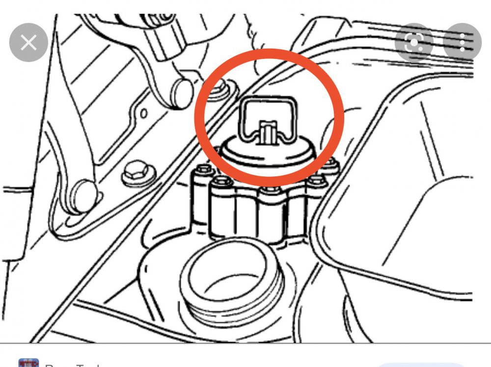

  1. I would top it off and leave your vent clip in vertical position. Keep some extra coolant in your boot. If your light comes on, on the dash, top off with extra fluid and keep vent open to allow air to vent until light disappears.

  13. Year and make of car? Open relief valve flap by moving it straight up (yellow arrow below shows it down) and drive bringing the temp up for a while. Another thought might be if you may have a diverter flap in the heater core that lost it's foam. The flap diverts the air from the heater or from the air conditioner depending on what is called for. Do you have grey/blackish bits of foam coming out of your vents or on the floorboard? If there is no foam covering the flap the heat can't get diverted to the ductwork.
