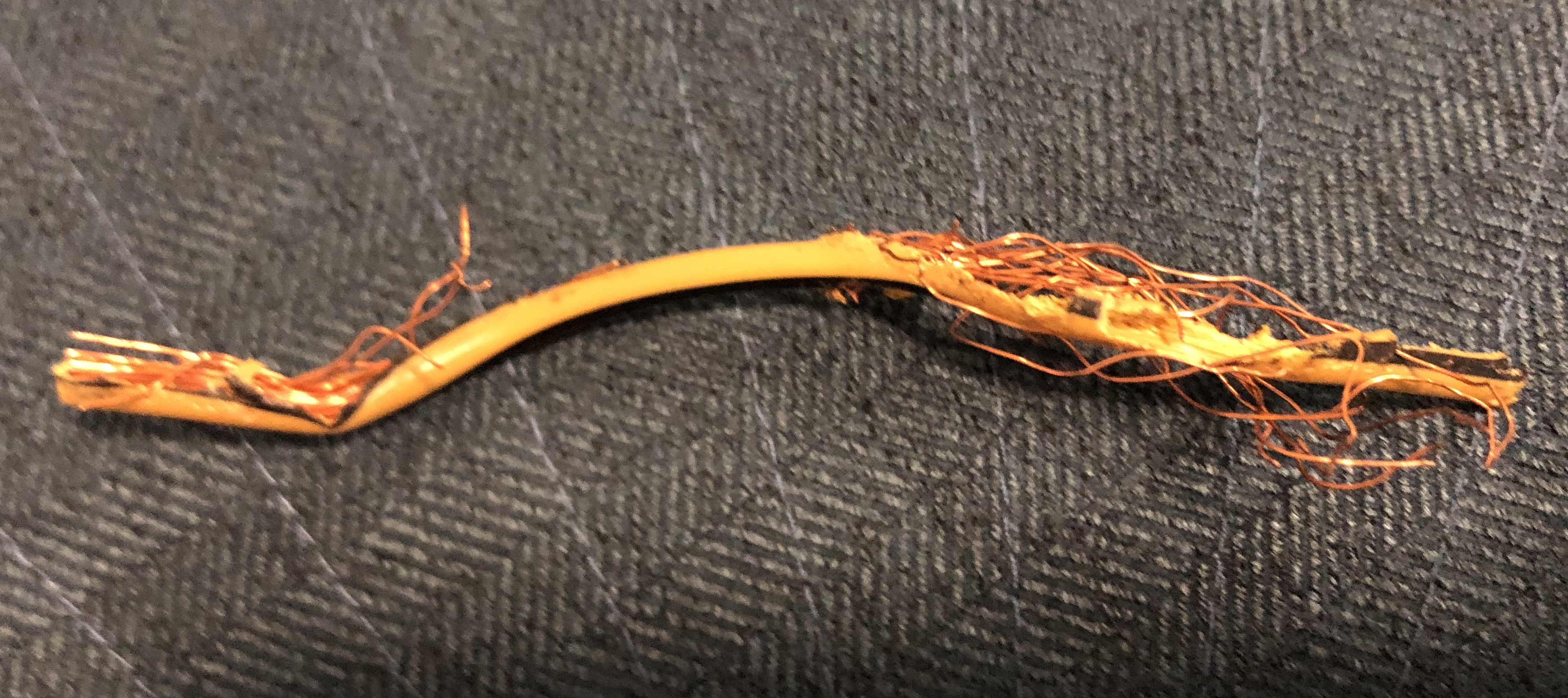

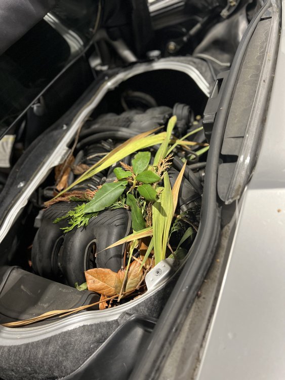

  3. So I had the car towed to a great independent shop. On visual inspection of the engine compartment, they found a rat's nest and the starter cable had apparently been chewed into two. A relatively easy repair. Thank you to Scan Automotive in North Vancouver!

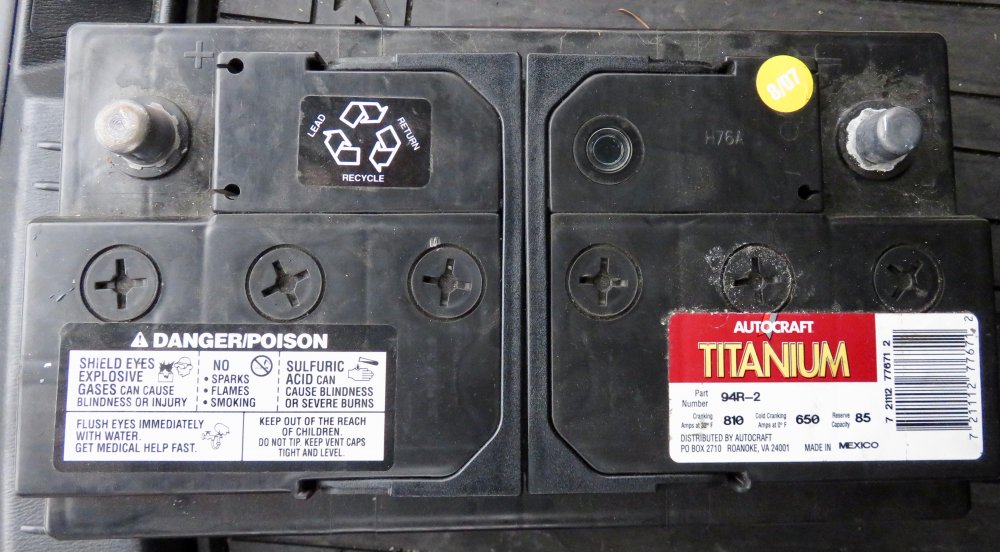

  11. I finally had to change the battery in my 2016 Boxster S. When I bought the car used, it already had this Autocraft aftermarket battery in it. I'm not sure why, as it would have been under warranty then. That Mexican made battery lasted almost 10 years. I have put around 40,000 miles on the car, mostly on the freeway, over those years.
