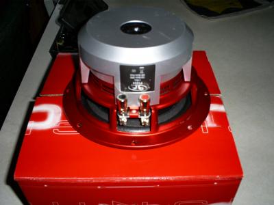

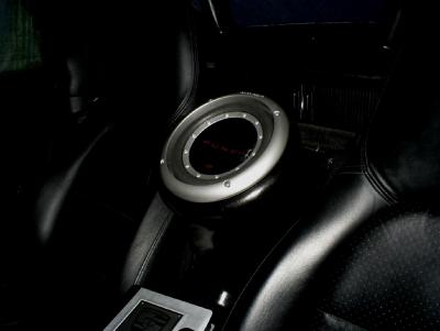

  3. A handsome ROCKFORD FOSGATE P8S4 came in today, with a huge magnet & coil(5"depth). then sub was mounted ,,,

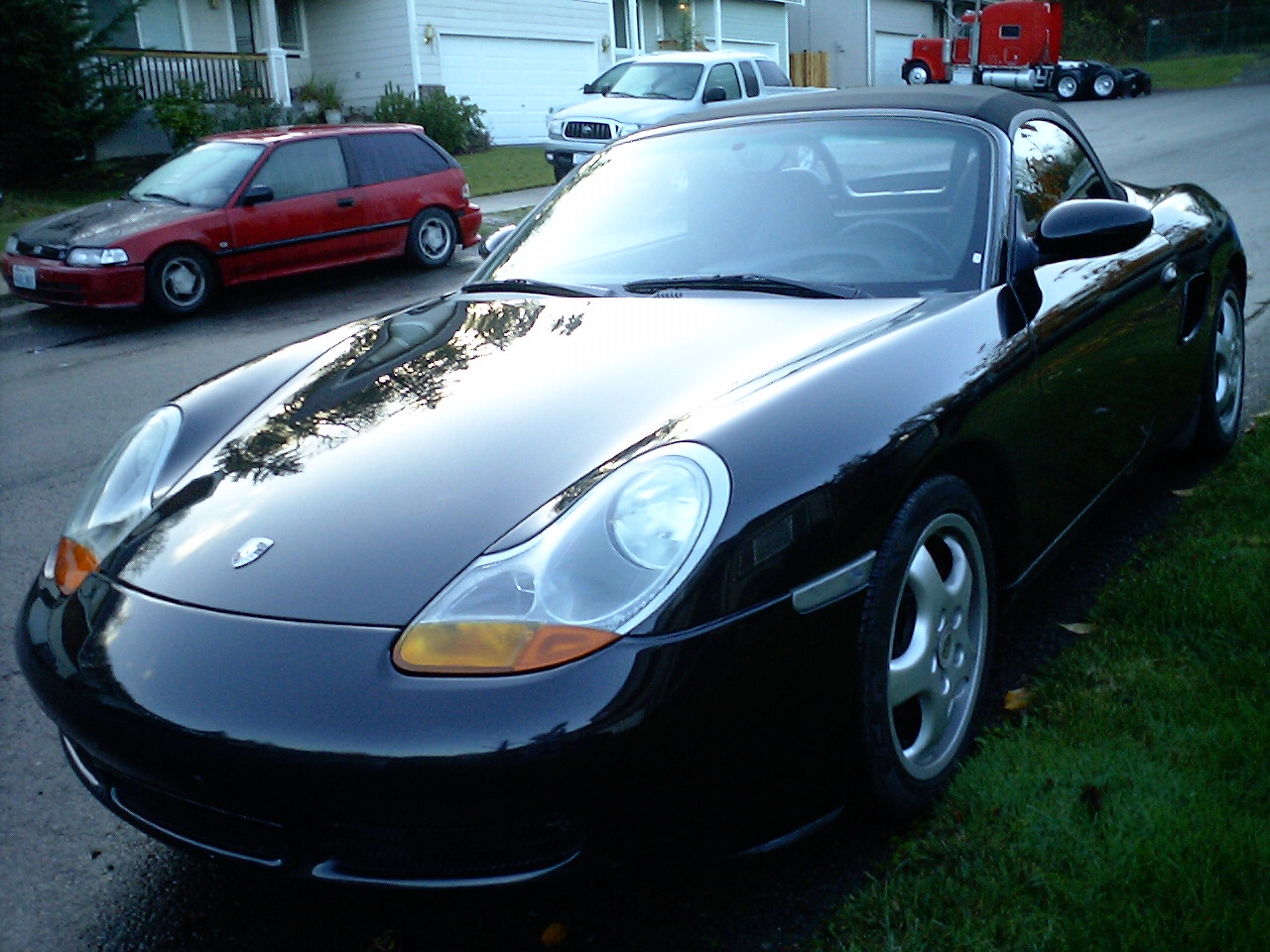

  9. For those who requested before & after pix + possibly thinking about upgrading their wheels. Here is a good pic of my front view to compare, I think - 17"CUP'S to staggered 18"S,smoked amber,smoked marker,silver crest,LED day running light + Zymol black wax,,, think a few modifications changed the look of my car, a lot more aggressive Now SHE can be eaily seperated from the other 986s B)

  14. I gotta say man I appreciate all the input & concerns also. lol yup sometimes its hard being a innovator? I try at least. And it is extremely difficult to mount a sub in a 986. But some1 has to try,,, Anybody has a better location or better idea? LOL( no trunk lid or door rattling please) peace officer ? hahaha I could careless, my window is 5%, most of us have no front license plate,desnorkled. I'm sure list can go on & on . Yes I do own both NAVI & ESCALADE, I guess I'm just big on my system. U should see- I got 2- 15'S(NAVI) , 4 - 12'S for my Escalade. I thought I was going pretty light & small on this 1 B) This is what makes the world go around,,,,,

  17. WOW 2 eights? where r u going to fit all these? BTW your 2 seats vertically. they r gonna be taller than ur roll bar,,,LOL U can wire 2 8OHM subs running in parallel then bridge it(4OHM BRIDGED equal power as 2OHM mono) to your ROCKFORD U definitely need some tweeters. above 1000~2000 HZ is gonna be lacking!
