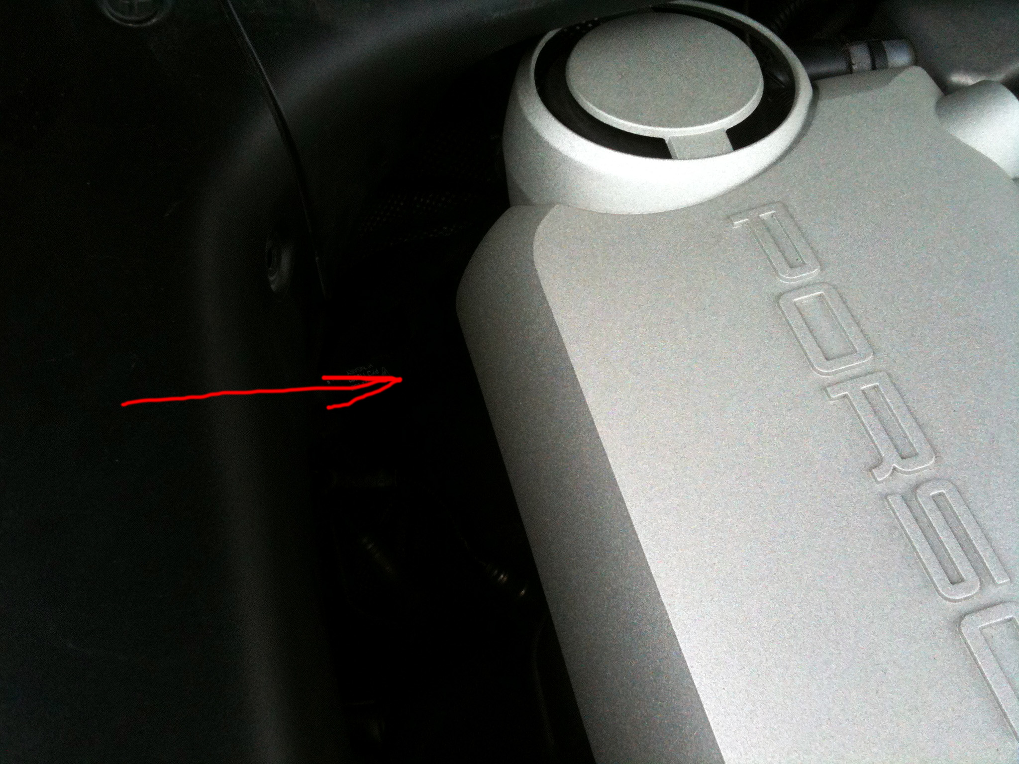

  1. I have a 2011 3.6 and I'm having coolant leak by the flenge Under the intake Passenger side. I ordered today the flenge part 95510623100 and gasket 95510643100. And soon I have to open the valve cover to change the PCV diaphragm in the air oïl separator. So let me know where you find the coolant leak in the valve cover or around the valve cover. Thanks

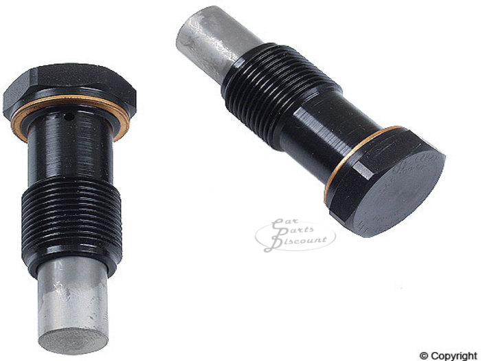

  18. Here is more information: If you look at the picture, you will see where is located the upper timing chain tensioner. The last picture is the defect part with the new box and you can see the part number (vw dealer number, same as touareg 3.2L). Check this picture and you will see the week free play of the tensioner (the chrome color). The brand new part is able to move like the green line, and the defect only the red line distance. This resolve about 95% of the problem, but I drove about 100,000 km with the defect tensioner and I probably damaged the timing chain or the lower tensioner. If you go to youtube, you can hear the noise (about a minute after startup) before I changed the part: Thanks I hope this will help you. Just let me know if it works on your engine. GUY
  19. I had the same problem since I own my 2004 3.2 V6... And one Renntech member (thanks him) find the problem and it take about 5-10 mins to fix it. Go to the vw dealer and order the upper hydrolic timing chain tensioner (same as the touareg 3.2). In canada I paid about 60$ but probably cheaper in usa. Make sure your car and engine is not moving and put the handbrake. If you face the car on your left side from the top of the engine put your hand just over the cat (make sure engine is cold) and you will touch but not see a 27mm hexagonal bolt. Take a ratchet and extension remove old tensioner (few drops of oil will drop) take the new one soak in it in oil and put it back slowly and tight it. At the first 3-4 engine restart you may hear knocking noice, probably the computer need to adjust. I made it this week, I can provide you the part number if you want. I have video showing exactly (before) the loud noise and at 4250 rpm and up engine running smoothly. It also fix the knocking during warmup. Even Porsche dealer where not able to find the problem, thanks to Renntech.

  21. Thanks for helping me, it's really appreciated. I sent this video to porsche dealer, spoke with many specialized people and NO one else was able to find the problem. What you told me is very logical, because when the engine is cold the upper tensioner is loose and knoking and when oil pressure slowly come into the hydrolic tensioner (probably defect and slow to react) the noise come off slowly. This also explain the misfire on cyl 1 and cyl 5 because the loose chain may disturb the timing a little bit during the warmup. I just want to know when I'll replace this part, if I need to secure the timing chain or I can safely just change the "bolt" without droping a guide or a rail in the bottom of the case. I probably need also to bleed the part with oil before replace it with a new o ring. Thank you very much, I was trying to resolve this since two year and I think I'm very close to tell you... You are the best.
