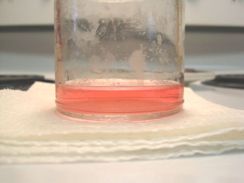

    1986 Porsche 944 Turbo

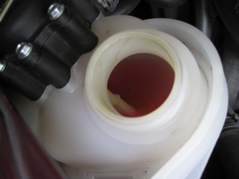

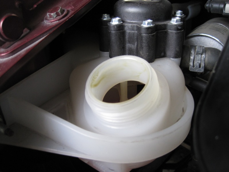

fbgh2o's Achievements
