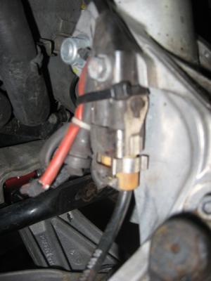

  22. I've not experienced that on either my 996 or my 986. I wonder if something was thrown up in the wheel and snagged the wire. There is a connector mounted on the side of the wheel carrier. In this not-so-great-picture, you can sort of see what I am talking about. The speed sensor and wear sensor plug into this. (In this picture, the wear sensor wire is coiled and wire-tied off - this is a dedicated track car, and I don't use the sensor.) Is the wire split above this connector, or below? If below, you can buy a replacement and just plug it in.
