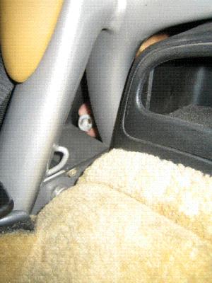

  5. Hi Chris, Thanks for your response. The B rode is the bar located right behind the seats (well, it looks like a B lying on its side)... I recently replaced the "top push rods" and its def not it, I checked those nuts/screws. The system is intacted in all 3 of those places you described, allowing the top to rise at the same time. The problem lies in that the front part of the convertible top lags out while rising on the driver side and rubs against those bars behind the seat (b rods), which prevents it from rising as easily as the passenger's side. I tried looking underneath the convertible top for any loose screws etc, but it is difficult to assess since it's complete sealed off for exterior access... anyone else have any ideas? - Mike
  6. P.S. I don't think it's the transmission cycle being out of sync because as soon as I reach back and release the area that's rubbing against/stuck on the B rode, the top closes normally.
  7. Weird problem that just started occuring. Top was working fine with no problems, then all of a sudden this problem starts. When I close my top, it closes fine..the motors spin evenly at the same time, etc. It closes great and evenly. However, when I open, the passenger side goes up when it should, but the driver side lags. But not only does it lag, it is PUSHING on the back of the B rod of the driver side. I think it's lagging because it's stuck against the B rod and trying to go up. When I reach back, I can release the front part away from the driver side B rod, then it goes up normally with the other side. So my question is, is there some sort of adjustment that somehow loosened up? For instance, is there some sort of bar or string that's supposed to keep the front part of the convertible top from rubbing against the B rod? Because it is definately getting stuck on the B rod...so I figure there's some sort of part that keeps tension so that the front part of the convertible top is constantly pulled back a nudge. Further, putzing around, I found a nut on top of the drain..but I have no clue where that nut goes. I'm assuming this nut belongs to this adjustment piece....any ideas? I've taken a flashlight and looked all over for where this nut could go, but I didn't see any loose ends...maybe I missed it somehow? Thanks for any help. Regards, Mike

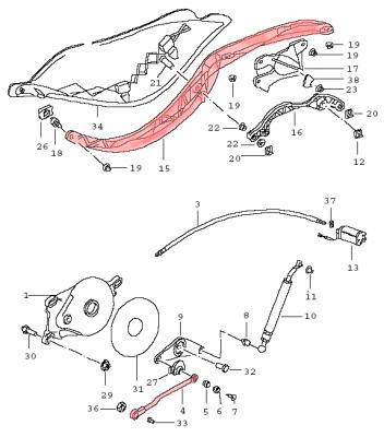

  10. Hi guys, The part # is "4" from the diagram. Sorry for any confusions. I am going to take pictures and write steps for this fix. (I couldn't find one anywhere). I pretty much know what to do, but i am having a LOT of trouble removing the ball joint that holds the canvas down (since it's in the closed position)...so I can fold the top back. I have enough problems removing this ball joint when I can open the back half way. i am trying to do what mark is doing in this thread: http://www.renntech.org/forums/index.php?showtopic=662 It just won't come off!!! Any advice on how to remove this? I remember when I removed it before, it either comes out SUPER easy or doesn't come out at all. Any pointers? I've spent the last hour wriggling it around and pulling whichever direction i could think of. Thanks! - Mike
  11. Hi everyone, I am a complete top newbie. After spending the last two days on this forum reading through the threads here, I think I have somewhat diagnosed the problem. (pictured below) Can you guys please tell me: 1) What this part is? I believe it's #10 on the parts image below. 2) How much and where can I get it? 3) Are there any special tools I need for the fix? 4) I am currently using one of the guides on here on how to manually open the top from the closed position, but does anyone know if there's a thread on how to fix this part? 5) Do I need to order any other parts other than part #10 (if that's the one?) It's broken on both sides. Sorry for so many questions, but I just wanted to make sure I had all the materials necessary before I begin the fix. I need to use my car everyday and don't want to unhook the ball joints twice to put the top into service position. Thanks everyone!! - Mike P.S. I have a 99' Boxster
