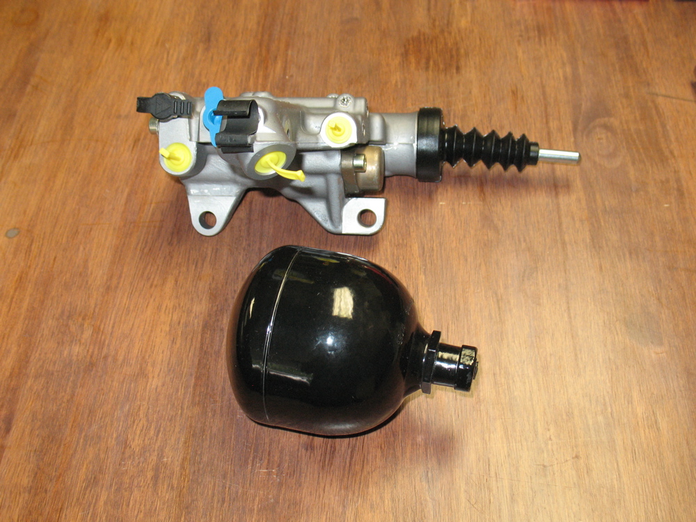

  7. There is a test as per Repair Manual for the accumulator: 1. Checking accumulator 1. Cold start engine (accumulator temperature approx. 20°C) and let run for approx. 20 seconds (accumulator is full). 2. With the engine switched off, depress the clutch pedal repeatedly until an abrupt rise in pedal resistance against your foot can be felt (accumulator is empty). While doing this, count the number of depressions carried out up to the point of the rise in pedal pressure! 3. If the number of times the pedal was depressed is over 35, the accumulator is faulty and must be replaced! Accumulator part# 996 314 166 00 price about $120.00 Clutch slave cylinder part# 996 116 237 52 price about $430.00 I also made a DIY Clutch slave cylinder and accumulator replacement
  8. Accumulator consist of a reservoir with a rubber membrane that divide the reservoir in two sections. On one side there is pressurized air and on the other side clutch fluid. (Pentosin) When you start the car the steering pump pressurized the fluid inside the accumulator and provide you with extra clutch application in case of drop of pressure. This is done by the air under pressure on the other side of the membrane. I guess Porsche engineers installed these accumulators to backup the steering pump when engine idling...

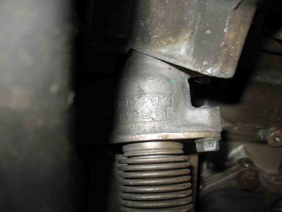

  13. I got this growling noise for two seconds on start-up and it is ok after engine oil pressure build-up. Check the TSB 1728 and I got the light blue dot on the valve also the bolts got a light blue touch-up on them (see pics) but the part number on the valve is not as per TSB. It should be 996 207 012 74 that number supersede 996 207 012 73 but the number on the case looks like 996 207 112 2R (???). I guess it is the number of the case not the assembly...Can it be possible that even the modified check valve is stuck open....
