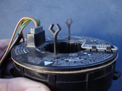

  16. My vote is the clockspring! You have to remove the steering wheel to get to it. It's the unit that transfers your electrical wiring to the wheel. It also helps with canceling your turn signals. It turns back and forth with your wheel and definitely can make that noise. It is not made to be opened for repair, so unless you can live with it, you will have to replace it. I think it's about $250.
