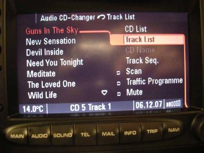

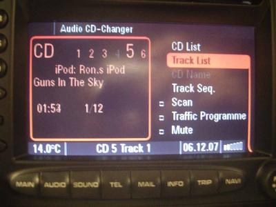

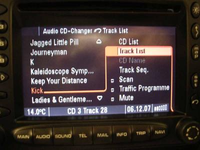

  1. Hi Gert, I have PCM 2 (Software Version 3.0) I dont have ABC search in my track lists. Are you accessing your songs through the menu which is found where CD 6 is or through CD 5 (see picture) I have attached photo's which I hope helps to explain what I see when using my GW500 in normal mode. I have shown artists play lists and songs from that artist.
