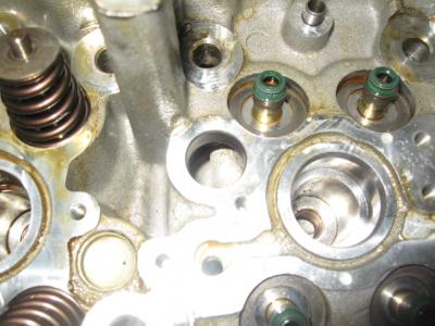

  5. This I believe is one and the same -- the plug I am referring to is in the cylinder head. It caused coolant and oil mixture and **** the engine down. It got mis-diagnossed as a cylinder liner crack -- I bought it site unseen planning on rebuilding via relining from LNEngineering -- but it looks like although we ripped all apart -- we don't have to do that. What I want to make sure is that if someone else had this problem -- what was the believed cause -- want to make sure I am fixing the problem -- and not just addressing a symptom of something else. cheers, M

  7. Do you know what the failure is exactly? Are you sure your engine is not rebuildable? Just had an '00 Boxster S torn apart -- with a coolant/oil geyser failure mode. Dealership claimed a cracked liner, but after we tore it apart -- all we found so far is a freeze plug missing from one of the cylinder heads, and found in the oil pan. Hoping that is the cause and not just a symptom.... but if so, a lot cheaper than other alternatives. m
  8. Has anyone had a freeze plug failure in a Boxster (or Boxster S) happen in the cylinder heads? Our tear down of the failure of my newly acquired Boxster S is missing a plug. Original Porsche diagnosis was way off -- just doing some home work before we declare victory..... thanks, M

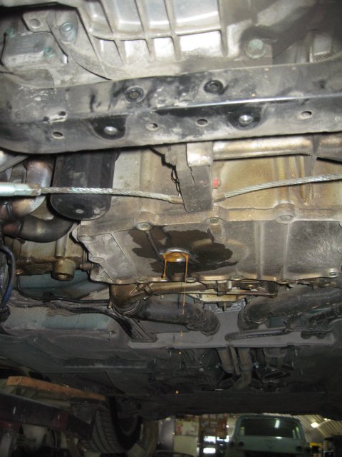

  14. I have foiund locally a mechanic that is reasonable and good to work with. I do the investigative work, he does the skilled labor. I am finding out what is possible and we are working together to make it happen Some things we plan to oursource, such as relining by LNEngineering, if it is determined that that is necessary -- the rest of the work will be done by us (well mostly him :-) So that is why I am doing the leg work and "engineering" the solutions and checking out the what-if possibilities. The engine surrouds were pulled last night, the engine should come out today. Here's a pick of the draining of the oil -- not pretty! Mike
