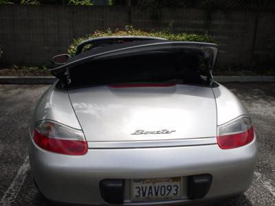

  21. Under the clamshell is a motor with 2 cables connected to it. Left cable and right cable. Disconnect the cables from the motor. First picture is from a car like yours. You will see a brass clip that holds each cable to the motor. Lift up on the clip to remove the clip and pull the cable out. Inside the black housing of the cable is is the inner drive cable. The drive cable is spun by the motor to make the top work. The drive cable had a square end. Second picture is my 1997 and your motor will not have the lever on top. Pull on the square end and see if the drive cable has broken inside the black housing. In the 3rd picture you can see a section of the drive cable has broken off from the rest. This also shows the square end on the left of the picture that goes into the motor.
  22. I reread your message and you may have closed the top while the tube was in the way. If so then the other thing to check is to see if you broke one of the plastic joints. Still need to put the top in the service position to see what is going on in there.
  23. I have see that more than once. The first thing to check on your year is to see of there is a broken transmission cable. This has already been covered in the top section, so start reading the older messages. You clamshell is probably tweaked but you can bent it back into shape, and this has also been covered. You got to get the top into the service position to inspect what went wrong or broke.
