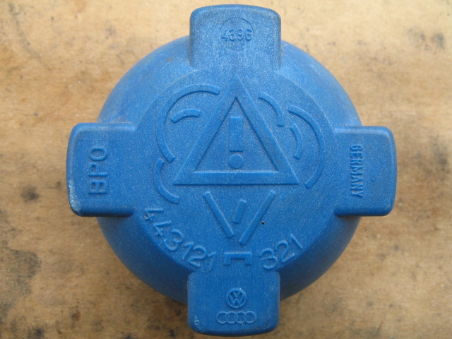

  11. I have not been keeping up on this stuff since the .02 cap that was sold in a .01 bag for a while. The black caps I have seen were "aftermarket" but made by the same company. Did not pay attention to the old West Germany. As stated, VAG uses this cap. I have a January 1997 and my original cap has the VW/Audi logs on it.

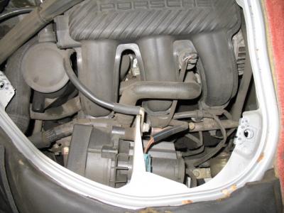

  16. Here it is on my 2.5. You can see the blue electrical connector that powers the pump.
  17. There is an electric smog pump that comes on when the engine is cold, then go off as the engine heats up. Maybe that is what you are hearing. The pump does sound like a fan.
