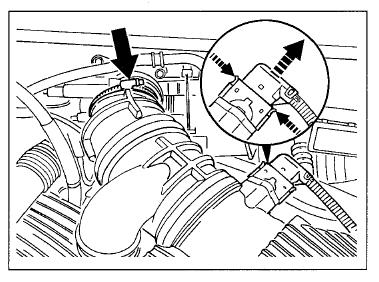

  18. If you aren't changing it, you can clean it in place. Just put a rag underneath to catch the excess cleaner. Strange that you are struggling to unclip it though. I think there are two types of clip, but it is usually fairly obvious once you get it in your hands. Edit: this shows the early MAF, where you just squeeze the connector, but the later one is a bit more tricky.
  19. I always undo the two screws and lift the MAF out of the housing before unplugging the connector. It means you can see the clip, which can be difficult with it in place (especially on a 996 C4).
