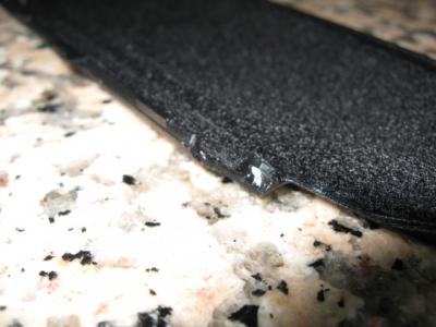

  17. The cover on one of my visor vanity mirrors just broke. Assuming I can buy just the cover, does that snap right in? I notice there are pins on each side that fit into holes on the cover. I read all the threads on visor cover issues, but I don't see anything dealing specifically with reinstallation of the replacement cover. Attached are photos of the broken and unbroken side of the inside of my mirror cover.
