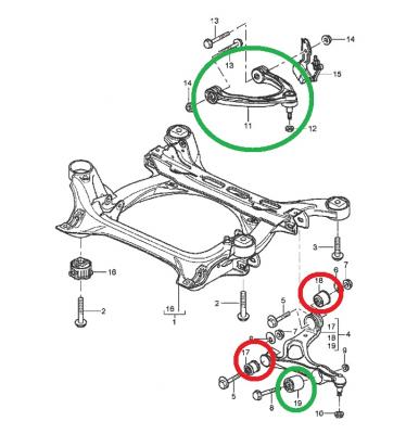

  18. Well as I've seen through forums people explain a lot, but no visual aid... I had same issues like you, but they got worse. I took my Cayenne Turbo to PepBoys and they replaced the bushings on the lower arm marked in red [17, 18]. These were completely broken. Also inspect the front bushing marked in green [19]. Noise gone, but couple of months later faint noise was noticed and replace the whole upper arms [both sides] marked with the big green circle... Begin with those items, due to low costs [bushings I recall were like $15.00 each. Upper arms were like $50.00 each]... I don't want to scare you, but don't let this issue for a long time unattended. Due to this simple issue, later on, the passenger's strut was internally broken. It cost me $1,600.00 each strut plus $400.00 in mechanical labor... Hope this could help you a bit better... Whatever happen, please reply so other members in the future could read the final result / conclusion... Just a suggestion... Good luck!
