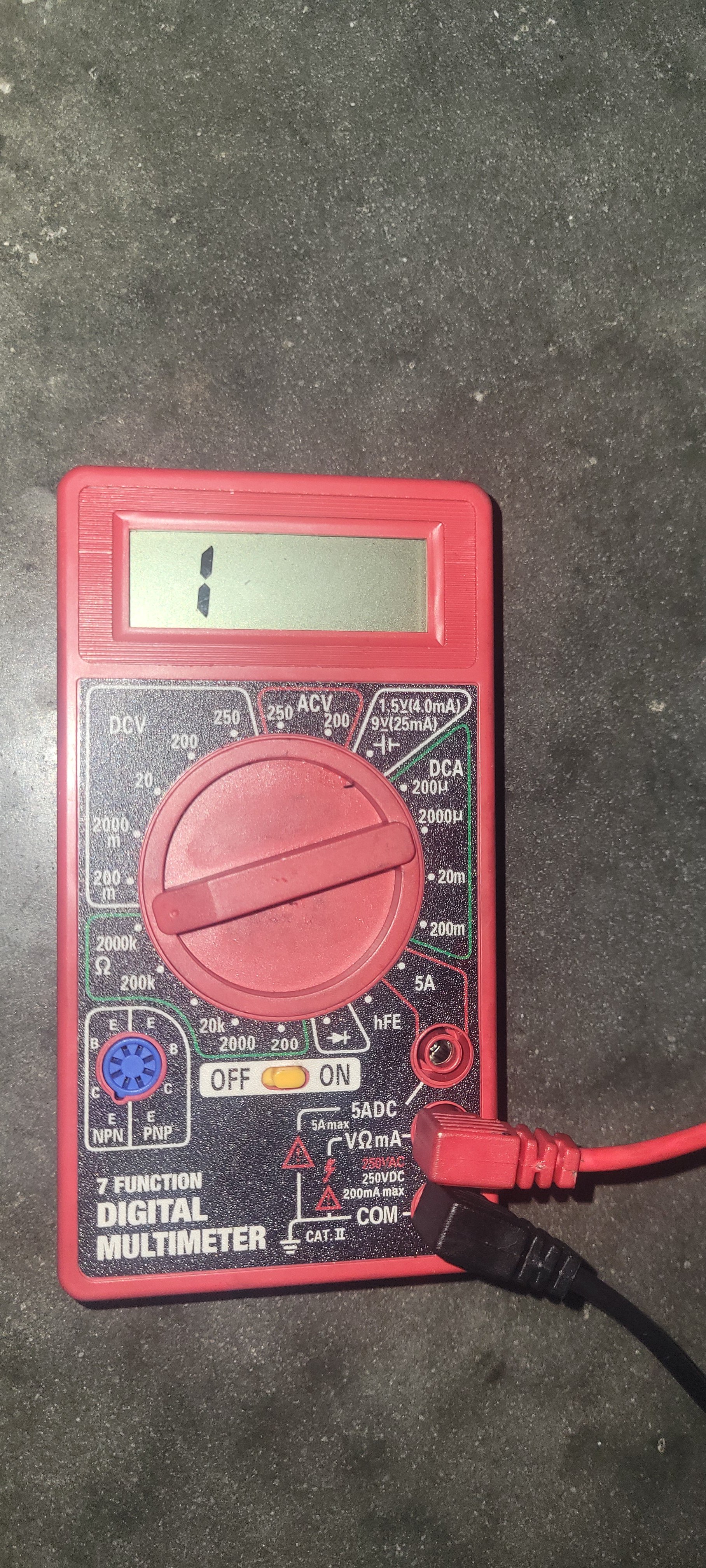

  8. Good morning JFP, I did a resistance test. Firstly, I tested pins 1 and 2 on the lowest setting. The reading stayed at 1 so I went up to the next highest. I consistently got as high as 911. Next, pins 1 and 3 reading stayed at 1 from the lowest setting up to the highest setting, so really high resistance. Looks like a lot of resistance overall. Do you think the CPS sensor is bad? I attached a few pictures.
